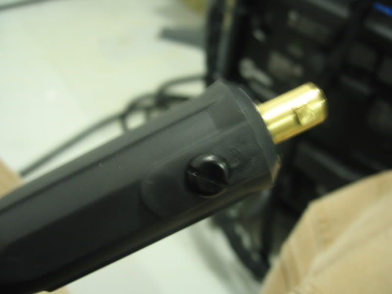

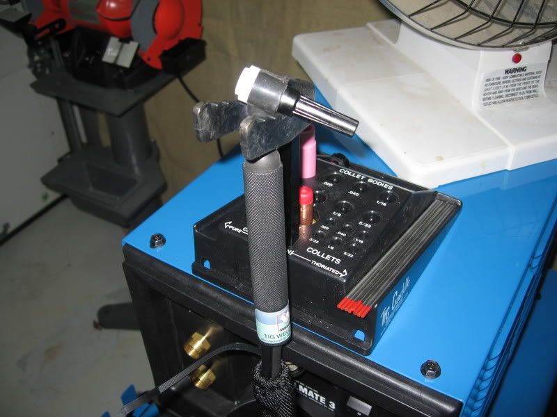

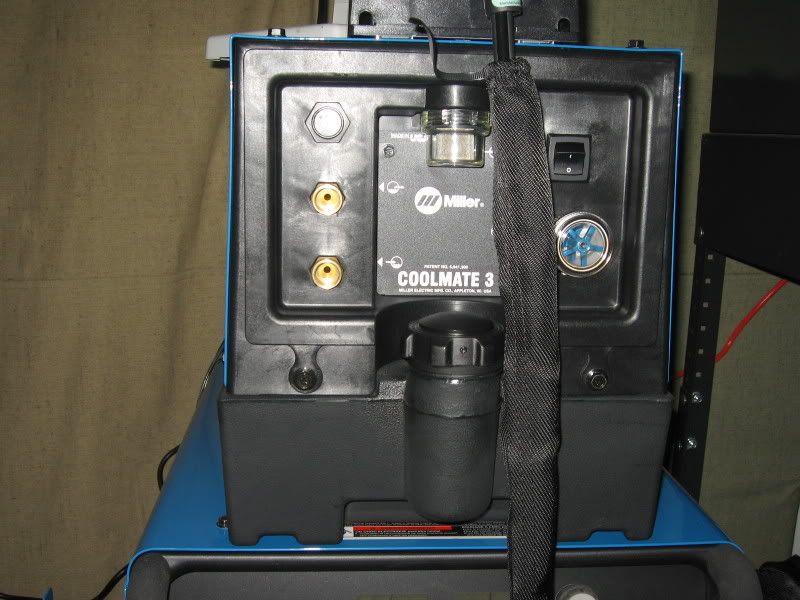

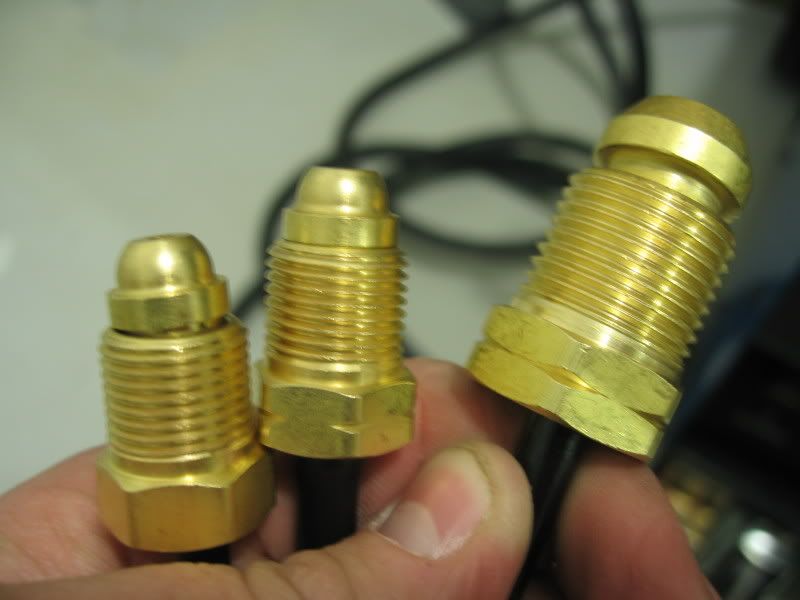

    ok guys I need help I just got a coolmate 3 and a wp20 water cooled torch and it looks like I am going to need a adapter. I dont know what one that I have to get. we have coolmate 3's on the 2 350's at work but they dont use the
    1/4 turn plug in and the thing is with the 200 the gas go's throught the power plug and I dont know what adapter will work with that.
    this is the one that I think I need to get name da-1820L part #195377

    the male plugs from the torch (left to right gas,cold water to torch,hot water back to coolmate)

    Chris,
    That looks like what you'll need.
    I recently purchased a Coolmate 3 and hooked it up to my Dynasty 200DX. I used the consumer resources available for free at www.arc-zone.com.
    To find the hook up directions for your torch:
    1. Click on Tig Torches
    2. Click on the applicable torch
    3. Click on Getting Started button
    4. Click on International Dinse-Style Hook Up Instructions
    The schematic provided showing how the torch is hooked up correctly to the power source and cooler really helped me connect everything the right way.
    The people at Arc Zone are really helpful.
    Hopes this helps.

          Does the bottom of that coolmate 3 have a molded hole/slot in the resevoir?
          My Syncrowave 200 has a tab sticking up in the center for lifting with a crane or forklift.
