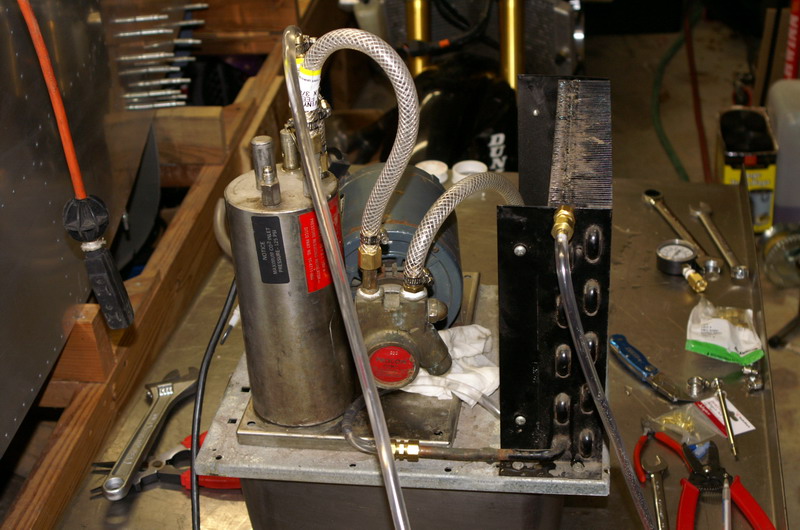

    Next I went to Home depot and bought a bunch of fittings and hose to hook up the pump and condensor coil then hooked it up to the welder.
    The biggest problem I had was finding the right fittings. Lowes and Home Depot don't have a big selection so I had to get a little "kludgy" with some of the connections. I was obligated to use 1/4" I.D. hose from the output of the carbonator tank to the welder since the 1/4 nipple was already on the welder. Since the fitting on the welder is reverse thread I could not easily change that without a trip to the welding supply store.

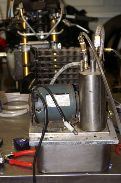

    Anyway, here are a bunch of pictures that show the unit set up on a small table that I use as a welding table for now. It's a stainless unit and pretty short which I like since I like to sit down to weld whenever possible. The table was $100 form the same restaurant salvage yard. That's probably a little expensive for a welding table but it's cheap for a restaurant equipment table.
    Here is a shot of the overall unit. The carbonator tanks adds quite a bit of height to the unit and I may remove it later if I decide to make a cover for the unit
    Here is a closer view of the unit. The smaller, 1/4 I.D tubing is going to the welder and the water return from the welder is shown going to the condensor
    At the bottom of the condensor you can see the drain setup. I just used some compression fitting to tie the vinyl tubing to the copper tubing on the condensor. You can also see the 3/8" I.D. reinforced hose feeding the pump. I made a bulkhead fitting that holds a tube that goes to the bottom of the resevoir

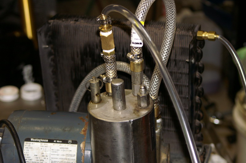

    This is the "kludgy" adapter setup I had to use to convert the 3/8" I.D tubing to the clear vinyl 1/4" vinyl tubing. I will try and find a 3/8" - 1/4" nipple fitting and remove this adapter.
    On the carbonator tank you can also see the pressure relief valve which pops at about 150 psi or so. The other unused fitting is where the CO2 is supplied. There is a check valve in there so it doesn't need to be capped. Besides, if I want to supply carbonated water to the torch all I need to do is add a CO2 tank. I think the piece in the middle is for the rod inside the tank that guides the float. In a soda system, there is a switch that activates when the carbonated tank is full of water and shuts off the motor.

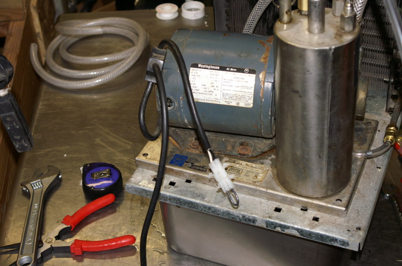

    This picture shows the motor and the unique wiring. The pigtail goes to a switch in the soda system that turns the motor on/off. I've installed a connector and used a jumper so the motor will run. My plan is to use a solid state switch and tap the solenoid on the welder. I know this is not the recommended method, but I don't want to have the pump motor run all the time. This way, the motor will only run when the contactors are closed with the foot pedal.

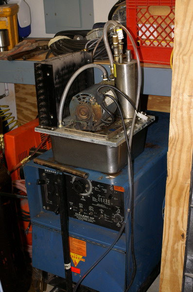

    Here is the cooler on top of the Dialarc HF. I will be taking it apart to clean everything up and secure the pump assembly to the pan. I will also use some Adel clamps to secure the water lines and motor cord to the side of the welder. I've still got to make up some hangers to support the torch and ground cable when not in use.

      looks like a realy nice setup. you have any plans of adding a fan to help cool it?? just thinking if you close that in the motor will create some heat and may end up heating the water insted of colling if the condensor coils dont have moveing fresh air acrost them.

              I hadn't planned on adding a fan since this is a 10 row, double deep cooler. I've got a small food thermometer that I'll stick in the water and monitor the temps. If it's a problem, I'll add an electric fan to the unit.
