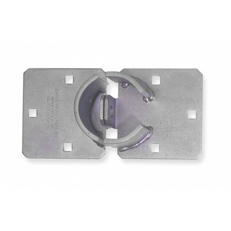

                My first thought for something easy, if there is enough flange around the door edge:
                    I have seen those somewhere (can't recall store) but I liked the idea of nothing visible to cut. I thought of adding a small pipe sort of like a tunnel to get to the key access point. Then taking the real key and welding an extension piece on it. The further the key access is recessed the more difficult it would be for someone to even pick the lock.
