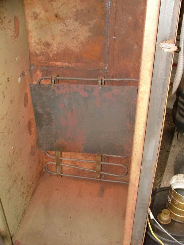

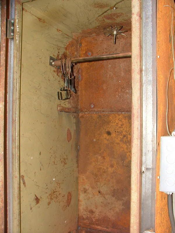

        M Man I used an old tool box about 8 ft. long and 24 inches square. Around this tool box I built an angle iron frame and attached the frame to the old tool box. That was a mistake, let the inerbox float. The heat will warp things if the tool box was not able to float. I had to go back and cut the frame loose from the tool box.
        The space around the box was filled with fiberglass house insulation and than the frame was covered with sheet metal.
        The heating element is an 8000 wat unit that I salvaged from a vacume forming machine. For the controlls I got a timer and a thermostat from Grainger. The thermostat controlls the temp and the timer controlls how long the the thermostat will bake the paint. My information sayes about 20 minutes. I also installed a small fan motor with a long shaft on the top of the oven and the fan part down in the oven. This circulates the heat in the oven.
        This pic shows the hanger bracket and the fan at the top.
        This is the controlls. The voltage is 220volts.
        The 8000 wat heating element is located behind the sheet metal plate.
        I used what material that I had laying around the home and every thing was rusty.
        Although the oven is not large it has worked well for me. You could even use hard house insulation and make it as large as you want.
