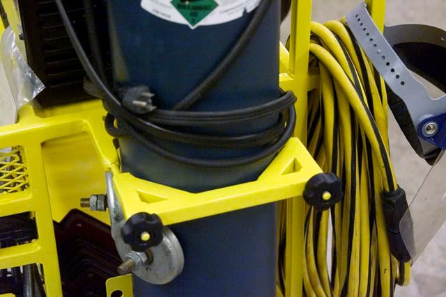

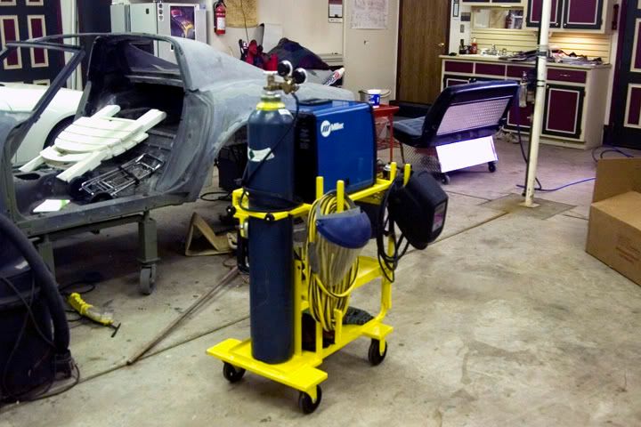

                        I welded the shelf under my 3/4 square tubing so it has a 3/4 inch lip all the way around.
                        • #13
                          Smooth72 is that a Corvette Stingray body in the background
                          • #14
                            thats a realy cool loooking tank lock down, i have not seen one like that befor. top shelf.
                            i guess i'm just a big scardy cat about wanting my welders straped down but i guess having a dirt floor makes mine a bit more needed.

                              Smooth72,
                              Where did you purchase the knobs for your tank lockdown?
