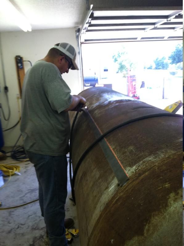

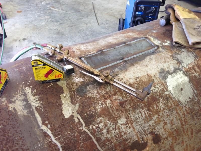

    Prefaced with I'm a weekend warrior so it's far from perfect but the mm210 hadn't gotten to make sparks in a while and I got the tank for $100 so I figured I'd give it a shot. Ways to go but it's getting there.
    I purged the tank with soapy water and tsp. Cut out the gauges/valves out. Patched.

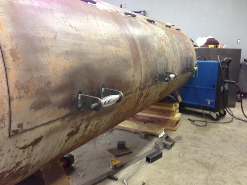

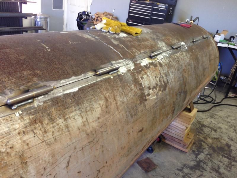

    Marked and cut doors.
    • #3
      Slide out racks.
      • #4
        Handles.
        • #5

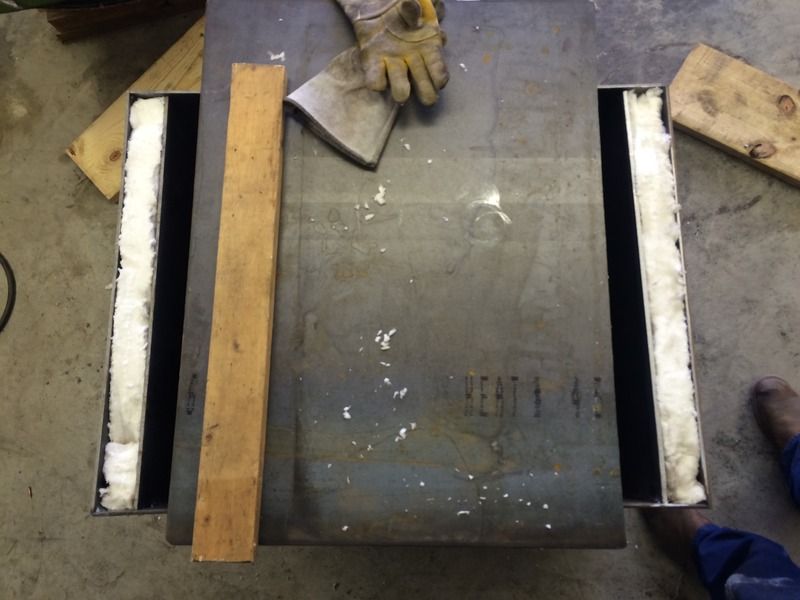

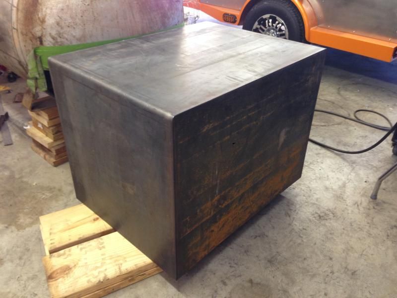

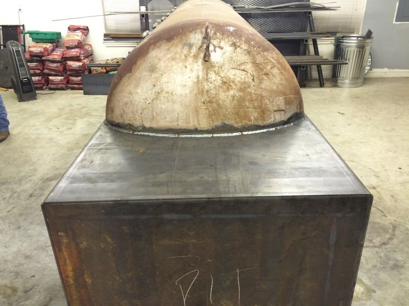

          Firebox shell.

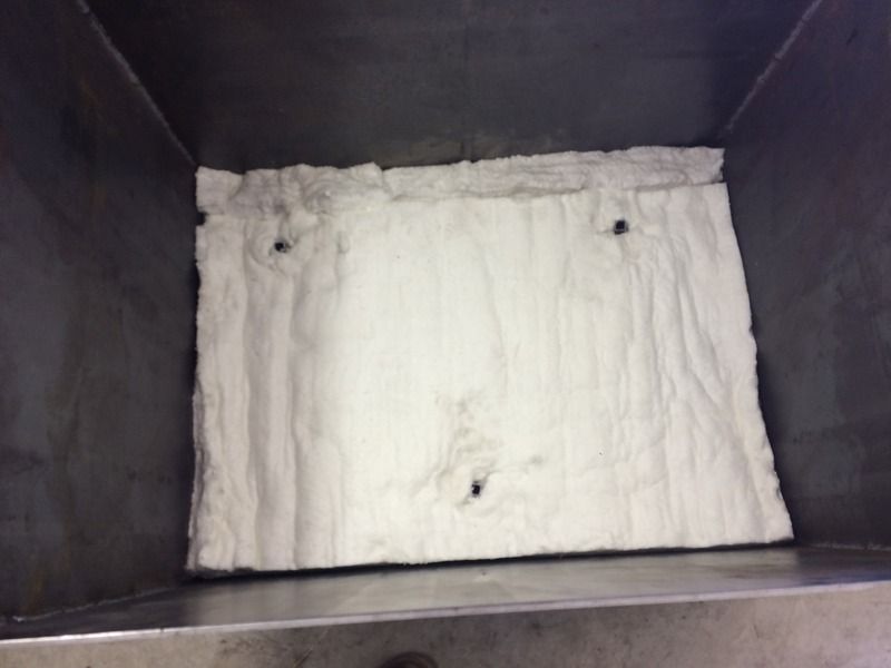

          Insulation and inner firebox.
          • #6

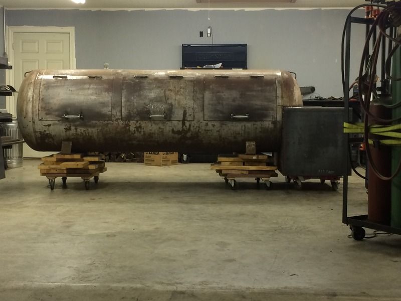

            Mounted firebox.
            • #7

                Real nice work..
                • #9
                  Looks great! With that size of BBQ, there won't be a mesquite tree left in West Tex after fueling it.
                  • #10
                    That looks GREAT!

                      Beautiful. one question on hinges. I guess it will not get hot enough to burn off grease? I saw the zirk fittings.
                      • #12
                        got a problem with those hinges too. we used them on the doors of wireline units and we ran into a problem with the brass just snapping in half for no reason. we ended up swapping them out with some made with stainless steel pins.

                          Watch out when you fire it up, the EPA will be looking to fine you.
                          • #14
                            Holy. That thing is big enough for a restaurant. I hope you have a huge family or lots of friends.
