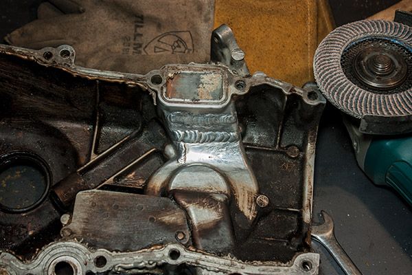

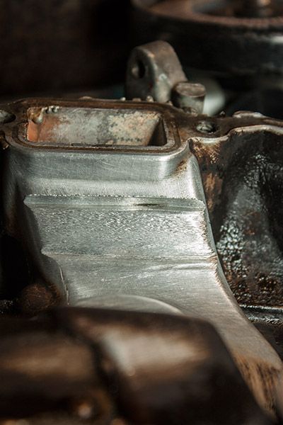

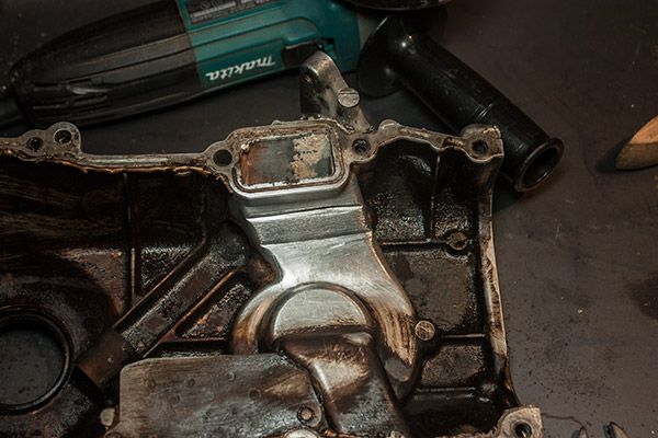

    Had a cast aluminum engine part, a timing chain cover, to weld up yesterday. These cast aluminum pieces are always interesting to weld on, sometimes it is good, sometimes not so good....
    Syncrowave 200, 175 amps, balance 7.3, straight argon @ 17cfh, 2% Lanthanated tungsten (sharp tip), 4043 filler
    damaged area
    a hole worn through the casting allowing water into the engine oil
    welded up

      Looks really good did the oil residue from the other side give you any trouble.
      Thanks, yeah I had to run a couple of beads and then grind them out because of the oil pulled into the weld...but that is pretty much normal for parts like this.

            Goat Driver, Next time, Clean it up good like you have done, dont ve-groove it as much as you did and go over the crack with the torch minus any filler metal at a few less amps than what you would weld it at.
            Doing so will bring the contamination to the top and grind the crude off the top and repeat this procedure until you pull most of the contamination out of the part, the reason I say not to ve-groove it all the way at the beginning is every time you clean the crude off you will ve-groove it automatically, if you ve-groove it at the beginning you wont have material at the end.
            After you clean it you are now ready to weld.

              That has not been V-grooved...that's where the timing chain wore into the aluminum.
