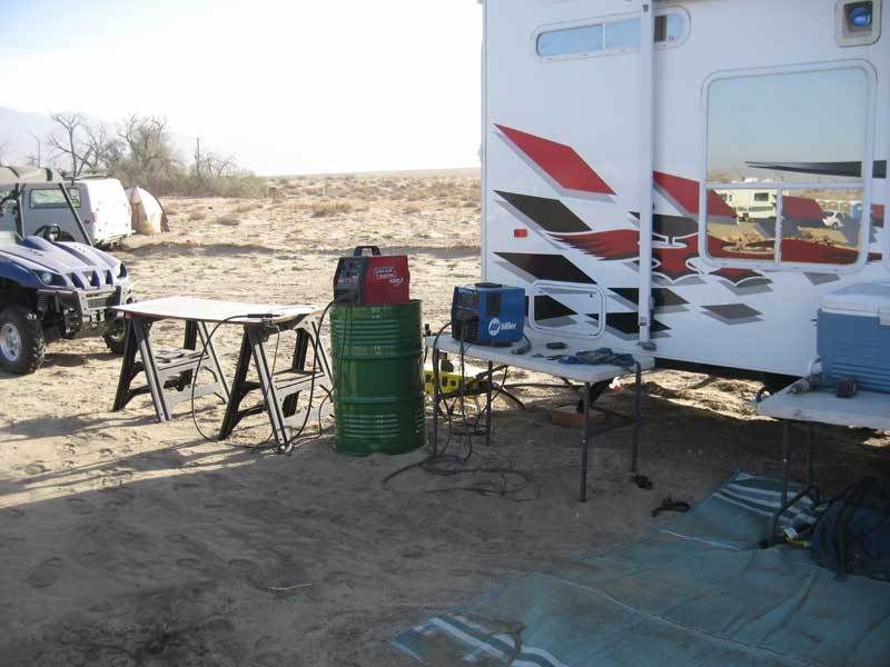

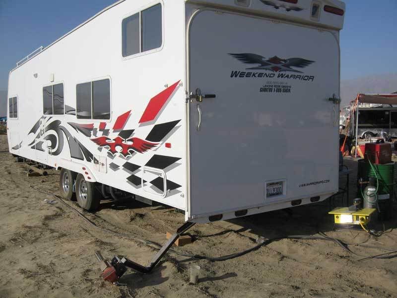

                            I did it with a Spider Box while camping. My Trailer has the 14-50 connections and I ran the cord to a Spider Box from the receptacle that is powered by the on board generator.
