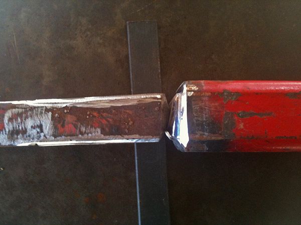

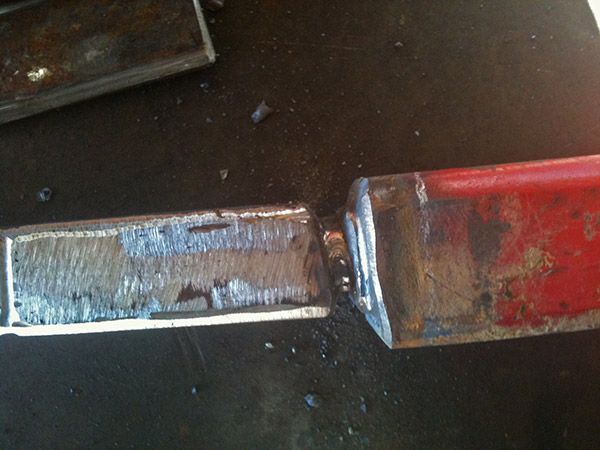

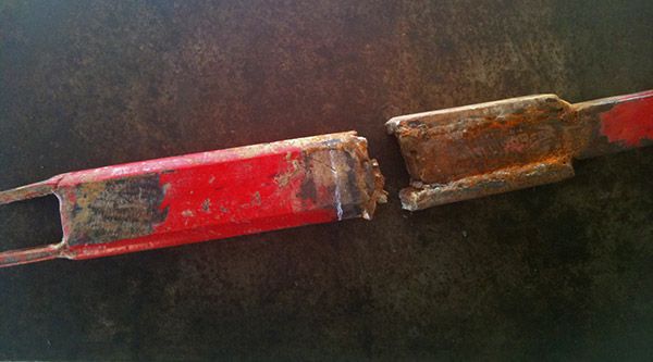

A farmer down the road from me asked if my son and I could fix his hay spear.....He had already welded on it before and it had broken again. We did the best we know how and sent it back to him...time will tell. It was good practice.
6010 root pass and cover pass and everything else is 7018
This is what he brought to us
We cleaned up the old weld and ground it out to a vee all the way around
Then we put in a root pass (hot) and cover pass of 6010
