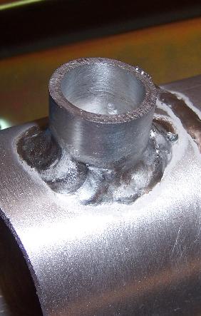

    My latest progress trying to weld aluminum. I only have enough time each day to practice one joint, so this took me three days to complete.
    The top fillet weld was tricky for me for lots of reasons. First, it is a fillet weld. Second, the two metals are different thicknesses. The small tube is roughly twice the thickness of the big tube. Third, it was the first time I tried to weld a round joint. Welding around a tube with such a small diameter proved a bit tricky when trying to keep a proper angle on the torch, get the filler rod in there, while continue to move around. This weld definitely will take lots of practice.
    The middle weld was next, and like the bottom weld, is just a straight butt joint joining sections of 3" diameter 16 gauge aluminum tube. I burned a few small holes in the middle weld, but got them filled in without to much trouble. You can see on the left side of the middle weld where the bead grows in width. That was a hole fill.
    Enjoy. Feel free to throw comments at me. Just be gentle.

      Please post your machine and settings(amps, balance, filler material, tungsten and size) for what you were doing for the welds. It helps us help you. When going thick to thin try and point the arc toward the thicker material. Once it wets out you will be able to carry it down a little and dab the filler in thus bringing it all together. Welding thick to thin esp. alum. is one of the hardest things to get a hang of. Also clean clean clean as well. Stainless brush and acetone. Wipe down the filler rod too. Practice and seat time also.
          Thanks for the tips. I was trying to aim the arc at the thicker piece and that did seem to be the way to go. The awkwardness of the size and shape were I think the single largest obstacles as I'm still trying to find what is comfortable to me. I kept thinking I need to put this thing on one of those pottery wheels so I can spin the piece and leave the torch in one position.
          As you say, practice and seat time. In general I am happy with my progress given the amount of time I've had to put into it.
          The machine and settings for this piece were...
          - ArcMaster 185 welder
          - balance @ 20%
          - 120 Hz
          - 1/16" Lanthanated tung
          - #6 cup
          - argon @ ~18 CFH
          For the butt joints...
          - 1/16" 4043 rod
          - 70 amps
          For the fillet joint...
          - some 1/16" and some 3/32" 4043 rod
          - 80 amps
            I can smoke two joints a day. And I'm older'n you.
            Poor excuse. There is plenty of room for the torch in that weld. A 90* weld, on flat stock will overheat much faster. You're too cold on that one. Don't be a sissy, it's practice; pedal it up. Your real problem is: that's really 3 or 4 welds and you don't know it. Stopping to rotate the piece is the problem.
            See above wise-guy comments.
            The middle weld was next, and like the bottom weld, is just a straight butt joint joining sections of 3" diameter 16 gauge aluminum tube. I burned a few small holes in the middle weld, but got them filled in without to much trouble. You can see on the left side of the middle weld where the bead grows in width. That was a hole fill.[/COLOR]
            That's exactly what you want to do on the fillet weld.
            Just be gentle.
            WHAT!!!!!!!!
            Weld 3: That's about as good as you're going to get with a hand held TIG weld. I told you in another thread; "If you pull this off, I WILL hate you." Congratulations: I HATE you.
            Again, the disclaimer: Root and I have the same demented sense of humor. This post is ALL in jest; excepting the accurate info.
            PS: Root; in the top left corner of this page is a User CP button. Please fill in your State. So I know how far I have to drive to kick yer butt. I've used up all of the smilies for this post.
            PPS: Ugly welds; even if you can hit it with a hammer, it's still going to leak.
            PPPS: Stop being so obsessed about cleaning (an*l is banned). I can see you wire brushed the cwap outta yer parts before you welded. If you look at your welds, there is a gray band along the edges of each weld. That's the AC cleaning the oxides. Unless there's grease or goo, the AC will do a fine job on its own. This includes cleaning your filler.
                While I'm not so sure about the sissy remark (hey mods! ), you might just be right about the temp. I was practicing 90* joints before this one and was getting used to the them. Switching to this, I was worried about burning out the thinner metal and just never quite got things right.

                • #9
                  I can't believe I'm saying this, but... using Craig's advice to crank up the heat on that fillet weld, I did and it helped. Sigh. What is the world coming to. . . . . .
                  I wouldn't call this perfect by an means (I mean, where are those dimes boy!), but it is an order of magnitude better than the first one shown at the top of this thread.

                            OK. It is just one of the things everyone seems to always stress about aluminum. Every post, article, etc. says how well you have to clean aluminum. Being a newb with no experience, sometimes it is hard to judge how far to carry advice. So sometimes I run the risk of being, um, an*l was it?, in an attempt to follow said advice.
                            There is overwhelming information against me on this point. I believe this myth (IMHO) started way back before there were readily available AC TIG machines. I, too, have spent hours stainless brushing and acetone-ing the filler. My welds are just as good either way. YMMV This may ruffle some feathers.
                            PS: It may take a second longer for the AC to clean off the oxides and for the puddle to 'glisten'. This is still faster than precleaning everything. Again; IMHO
