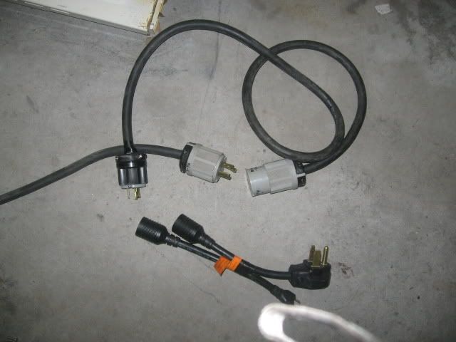

        • #5
          I had time to reconfigure mine:
          4 Prong 3 phase plug off machine to 3 Phase Receptical down to 3 Prong Generator (Twistlock) Plug, and then I can use either the 120 or 240 Plugs that came off my Hypertherm.
          With this I can plug into 4 different style outlets.
          Pic
          If your doing hime use only you could have your 220 plug on the machine, and a single 240-120 pigtail, and be set.
          -James
