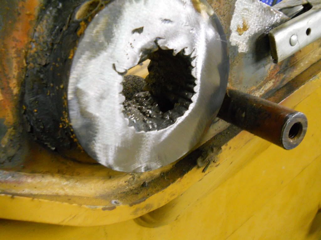

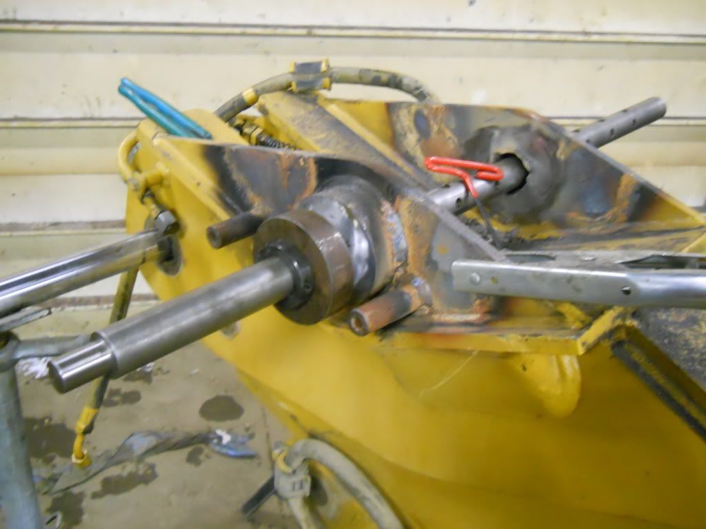

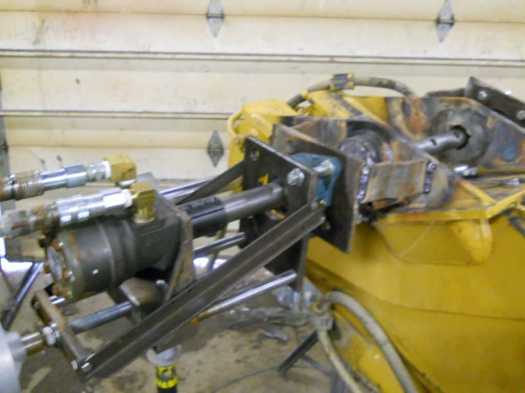

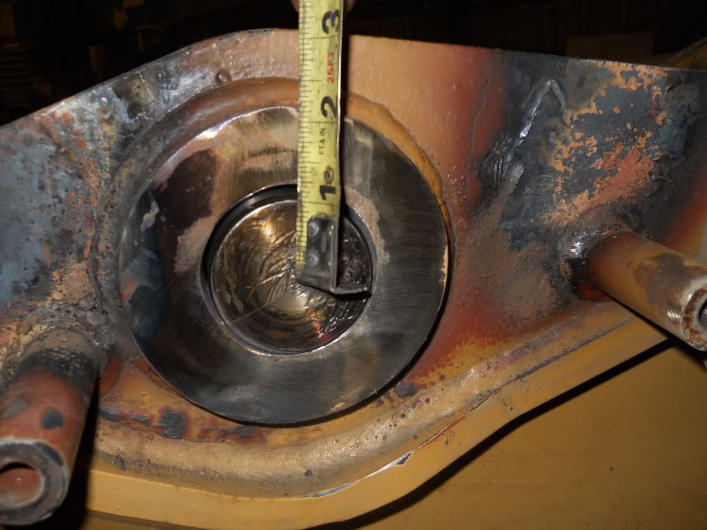

Wasn't to bad 1/4" in play on 2-3/16 pin
First we heated and bent the ears back in line rosebud and 60 ton portapower to pull it together
weld bore up
1/8 7018 110 amps
pics after straitening ears
weld bore up
install cones for rough position
