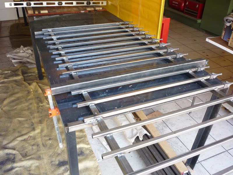

    I have an old jig thing kind of table that's seen a thing or two. A new project comes along and it gets modified the minimum to get the job done. So it looks, well, like it has been rode hard and put away wet way too many times.
    I had a hundred foot of fence to make. I'm old. Because of that and wanting to keep the weight of the panels down for handling I made six foot panels.
    The first thing is to eliminate the bowing problem.

      I welded a tab for each rail on to the jig. These tabs fit inside the rails.
      life is good
      • #4
        This isn't my first rodeo. I figured I would try out a one inch bow up front. It seemed like memory has it that I'll get about a one inch bow in a six foot panel of fourteen gauge one inch tubing.
        So I built the one inch bow at the middle in the jig. The far end is pulled down in place with C clamps.

              As you can see, I got lucky on the one inch guesstimation.
              Since there are only sixteen panels I pulled a tape for each picket. I will probably never ever need this particular version of the jig table again. If I was to do much of this I would of course weld int stops, keeping mind of course the need to slide the panel out to free it from the rail tabs, grin.
              I first tacked the pickets in place, one tack to the top rail and one tack to the bottom rail, opposite side to keep from rolling the picket with the weld pull.
              Then I ran it hot and fast as possible so that the heat would be pretty well uniform. I released the two C clamps and pulled the rail out from the tabs.
              It worked as you can see, came out of the jig already wanting to do right.

                      There is a way to weld it to prevent the panel from bowing.
                      The welds now are holding the pickets with a vertical weld on each side of the picket. So when you add up all of those transverse welds on the frame the pickets are attached to, the amount of shrinking of each weld is what is making the frame bowed because they are all on one side of the tubing . When all are added up.
                      Instead of welding vertically on each side of the picket to the panel rail weld the
                      pickets on the horizontal on the bottom of that top rail and on the TOP of the bottom rail.
                      That way all of the welds will be longitudinal on that panel rail and on the very corner. I will post a drawing.
                      The other thing you could do is to put the pickets on alternating sides and then there would be an equal number of welds on both sides of the rail the pickets are attached to. Shrinkage would be equal on both sides.

                          Sir,no disrespect but regradless of how you weld those pickets, as long as they are welded on one side it will bow.Fabricate a 6 foot section welded like you say and post a picture. I personally run my horizontal pieces thru my roll bender first to put a slight bend in it before I weld the pickets on but everybody has their own method.
