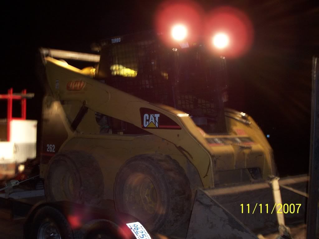

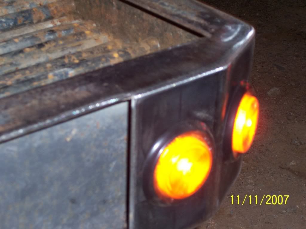

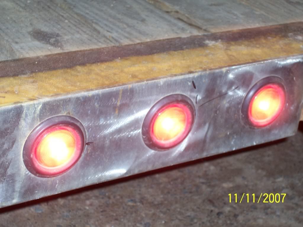

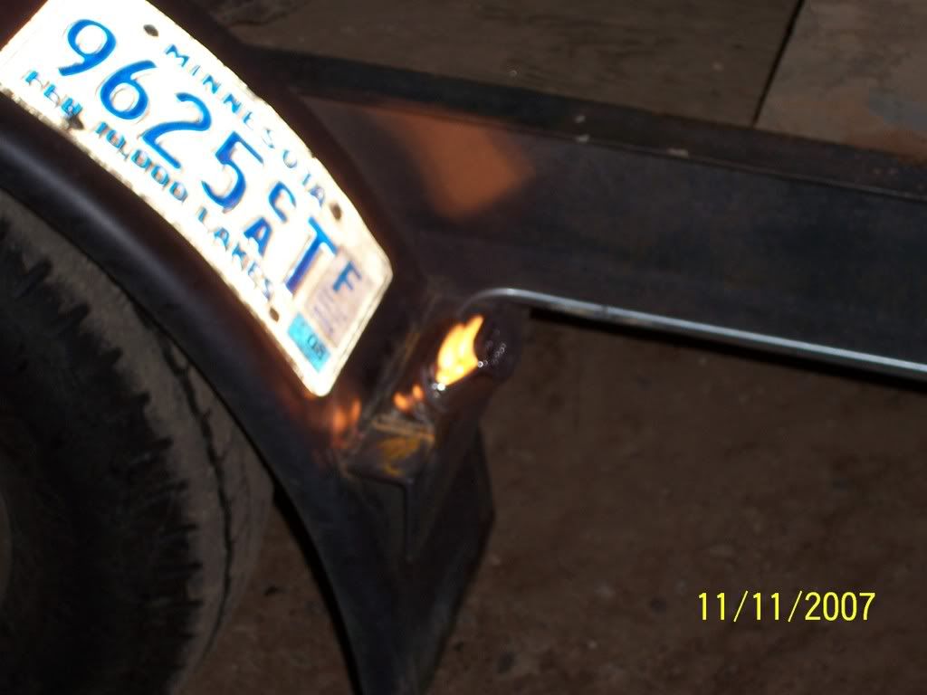

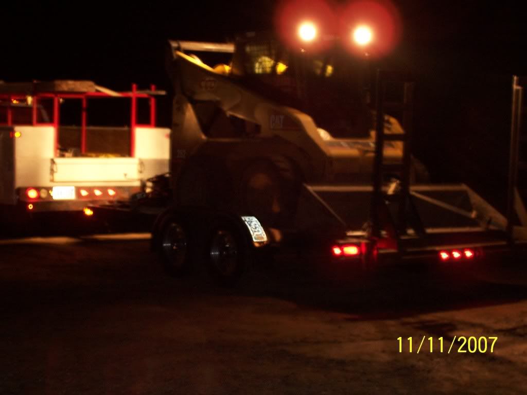

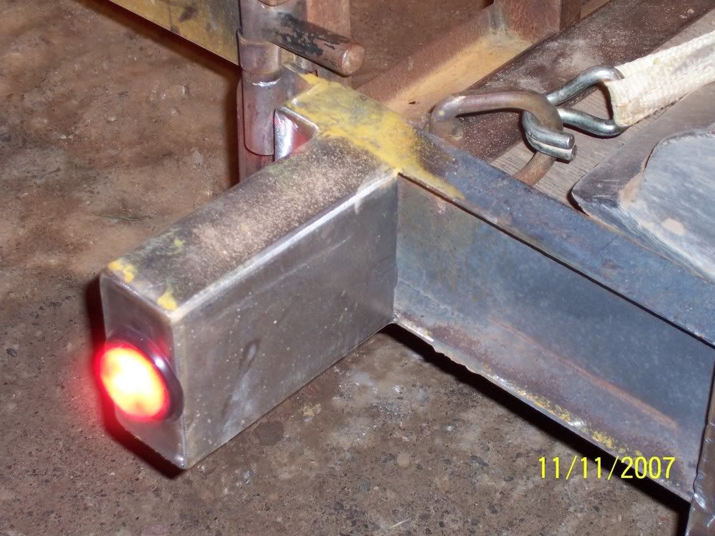

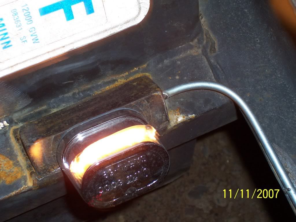

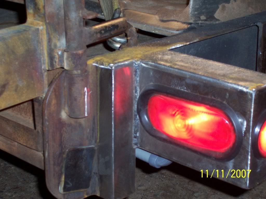

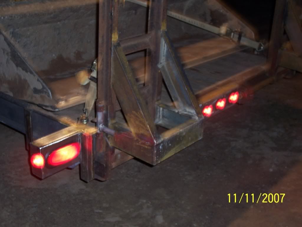

          My dad was given a similar trailer that was rolled over in an accident. The frame was twisted in certain areas pretty badly and it was significantly rusted in certain areas. I spent a lot of time bringing this trailer back to decent condition and now the guy who originaly gave it to my dad doesn't even belleive its the same trailer.
          The rear center light bracket is 308 SS and was welded on using 309 filler. After the trailer gets blasted and painted it will be cleaned up and polished. All wiring is enclosed and water tight. The machine is a CAT 262 and I beleive it weighs in at around 11,000lbs. I don't remember what the trailer is rated for but it's not an incredible amount more.

          • #6
            If I welded a rub rail on the outside of the fram and then welded 3/16 on the inside of the fram to box it in. That would give it a lot more strength. I know this traier will never carry a skidder do to how narrow the deck is, If I was looking to carry wheeled items were there is only 4 contact points I whould really have to beef up the fram. The loads Iam looking at carrying are bulding materials like dimensional lumbar and sheets of plywood, also firewood. The load is more spread out then when you have a smaller contact point like wheels resting on the deck.
            That sure is a nice rebuild on the equipment trailer. Looks very well built now compared to before.

                • #9
                  ? for Anti-GMAW. On the trailer you rebilt I see that there is a adjustable hitch, would you now the dimensions of it L x W X D and the hole spacing. I like the idea of adjusting the hitch and not the ball.
                  I see what you guys are saying about Dabar39, He seems like he is the trailer building king!!!! I have done a search on here for trailers and he sure has possted a lot of good info along with everbody else.
                  I am hoping to keep the trailer as light as possible but still strong . Whould using 3" c channel be better for crossmembers then bent up sheet stock in the form of a c channel ?
                  Thanks again for all your help
                  Jason
                  • #10
                    Sorry but that hitch is long gone in favor of a 2-1/2" ball and hitch. As far as C channel versus angle C channel is a lot stronger.
