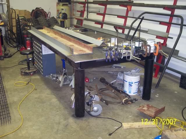

    For the love of god man, look at all the wasted space under that lovely table!
    Seriously, under fab-table space is usually completely under utilized. You're giving up on so much cubic footage it's sad.
    If you don't need the cross bracing for the legs (like the above bench), you could make a cart that fits under there and rolls out for easy access to all your stuff. It would be easier to build than making a drawer that served the same function.
