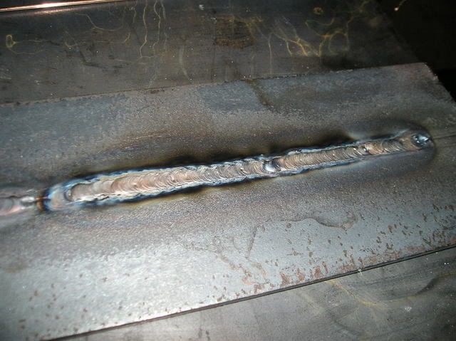

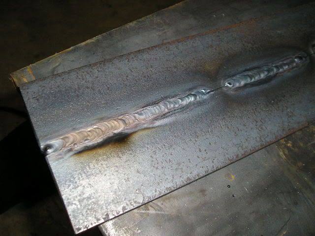

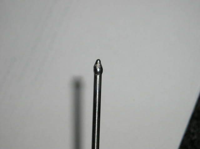

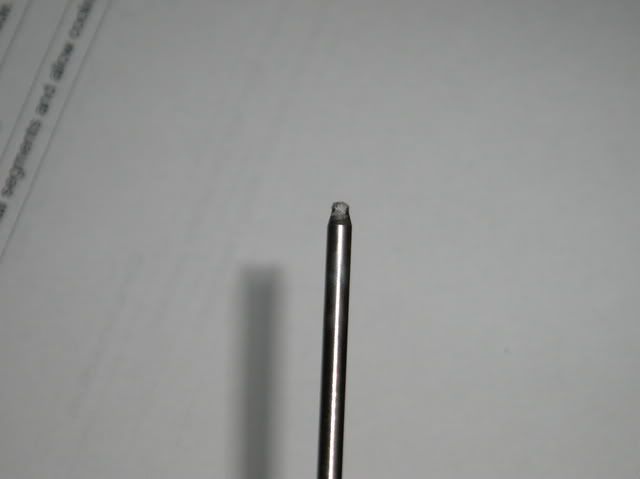

    What would cause my electrode to melt into this shape after about 6" of welding? It's 2% thoriated tungsten ground to a point DC welding 3/16" steel 150A. I was playing with the pulsing from 2-10pps. I found a chart and the closest thing I could compare it to was touching the filler metal to the tungsten, although I'm 99% sure I didn't...? Done on a Syncrowave 200. Any help would be appreciated
    This was the second time around after about 6" of welding:

    Trust me ....you did

      lol, ok. Does it look like the second one was touched also?
      • #4
        are you electrode + or - ???
          Negative....

            look for soot
            Is there any soot around your weld bead? if so you did touch.

            • #7
              Yes, there was a little soot around the weld bead. I was using the correct filler rod because it's the only kind I have right now

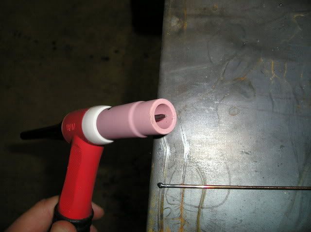

                  Ok, I've got it down enough to not contaminate the tungsten. But now after a couple of welds, I'm getting a black soot around the weld... What's that from?
                  • #10
                    What's your balance set at? Is your CFM/ gas flow set correctly? I'm not familiar with the 200, but does it have a %HF setting?
                      I can't change my balance in DC. 13CFH. No, I can't adjust the HF.

                        say cheeze!!
                        take another pic Toofazt. lets have a look

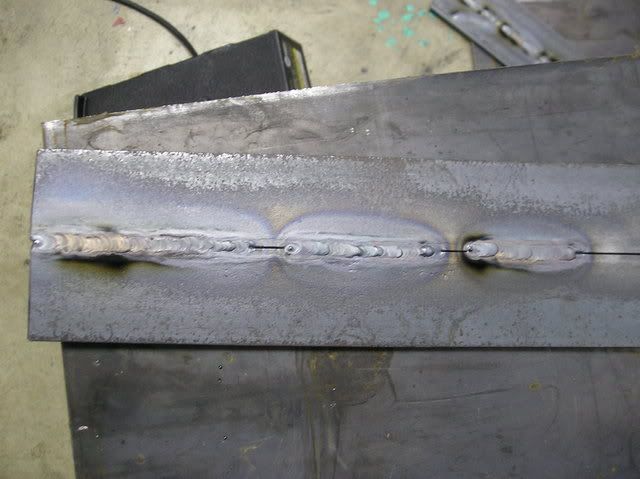

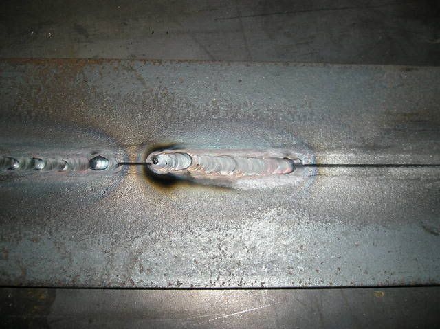

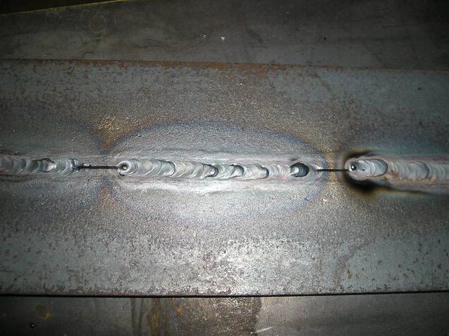

                          You asked for them... I know the welds suck, but that's not the point
                          It seems like I get the black soot when I slow down. You can see the differences in the pictures below. All welded one after another, just different speeds... I've also been able to keep a clean pointed tip on the tungsten so far Maybe I just need to speed up my welds?
                          150A, 10PPS.

                              Ok, I have no idea what is causing the black soot now. I just went out and welded a bead quicker than I was before and it just gave me lots of the black soot and pin holes
