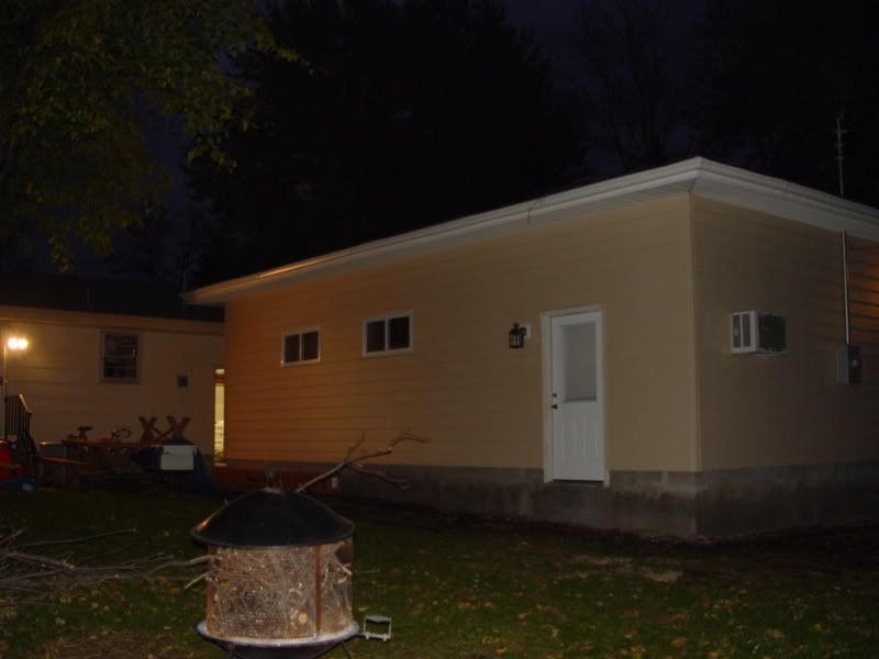

    I am new rookie to all of Miller Welds Guys. I run my own Garage’s shop (at home) to build custom cars. I had Lincoln Pro-Mig 135 for several years.
    The big reason I really need to have Aluminum weld because I work on custom cars at my own garage.
    I been have thinking to buy MillerMatic DV12 w/ Spoolmate(#951067) or 212 w/ Spoolmate (#951068).
    I concern about my home beside my garage. My house built in 1960's and has old style main (200 amps,?) electrical w/12 plugs and 2 boxed (30 amps) cartridges at wall beside my house in outdoor. Since the MillerMatic 212 require have 230 V/30-210 amps (160 Amps at 24.5 VDC, 60% duty cycle). I am NOT familiar with electrical things.
    I have Dryer (Straight Blade Device) outlet n garage. It is 220 Volts/30 amps. And, I never use it. Can I change it to be 220 Volts for welder outlet? Will it work?

    have a new service installed like right now by a licensed electrician
    you have many probs that i can see just from that pic
    also have him check out the inside of the house because 220 lines should be run with 3 wire not 2 wire

      I have to agree,,if you all ready have 200 amp service,,yours look like a typ 60 amp they put in the 60's,,It Just ooks scary!!!!!!Be safe!!!!!!!!and if you go sell your house,you wil recoup the money!!!!!!!!!Good Luck,Jack

        You might consider getting a powered welder such as the bobcat or trailblazer and using its power outlets for the millermatic. Weigh the cost differences...

          Yes, the drier outlet will work, but that old fused panel scares the *%#* out of me. I'd make a move on that right away.

            That is by no mean a 200Amp service. More like a 70 or even 60A.
            I could be wrong though i dont think that i am.
            A new 32 space seimens panel with a 100A main and enough breakers of all sizes to run you exisiting load should not cost more that aout 500 dollars and a days wages to install the panel. Now is the time to find yourself en electrician buddy...
            another thing to consider.... is the wire in that panel made of aluminum or copper. during the sixties, Aluminum was all the rage until they found out that it wasnt such a smart choice. Nowadays Aluminum is used to feed very large services where wire size is above #2 or so.
            Can you guess which of the above is better to have? If the wire is made of AL, give serious consideration before applying a welding load to the circuit.
            Aluminum wire tends to "loosen the screws" that is holding it in place. For some reason unbenounced to me, It deos not have resiliance and once you torque down on it, thats it. It will lossen up with time.This can cause exessive heat to build up and then fire.Ive seen this happen on heating circuits. It seems to be more pronounced on 240 volt circiuts. So check that out if you do have AL wire.
            if you change your panel, use copper wire of the correct size to feed the welder .

              Hey wow that box is scary. I would seriously take these guys advice on getting a new box and breaker setup installed one, for your safety and two to make the welder work. Also by law a house has to be run on a breaker service anymore.
              • #8
                holy time to upgrade, with the age of the stuff in there thats a fire waiting to happen

                  New service price breakdown based on my experiences:
                  You can buy a Square D 200A panel with some breakers to get you started for $120. Additional breakers are 3-12 depending on size for the smaller stuff and a 60A is around $20 (but you'd need another run of wire to be able to upgrade to a bigger welder like that, the current 10ga won't handle more than the 30A that's already on it).
                  You'll need a new drop from the mast and that'll run you about 300 or so in copper depending how long a run it is (3 cables). My 13' drop of 2/0 was 300. The utility co will provide the lines to the house.
                  Then you're looking at probably upgrading your ground rod and running 6ga or 8ga (I forget what mine is) to that which is pretty cheap copper.
                  And then you're talking about paying a sparky for 5-7hrs to make it all happen. So that's roughly 500-700 in labor. Plus a permit fee which will likely be around 100. Mine was 82.
                  My parents paid an electrician to upgrade their service and that's where the 5-7hr estimate comes from. They had a little different version of that box you have in their house.
                  I recently added a new panel, meter socket (which will cost between 60-200 bucks), and relocated the service entrance which meant a new mast for my house, which is where I'm basing my prices on. I'll be updating the house panel sometime in the future.

                    I just did one similiar to this myself, you do have a 60A service there. Upgrade that thing to a 200A. The lead coming into your meter should be up to par but check with your local electric supplier to make sure.
                    It is not a hard job to do as long as you know what you are doing. It will need inspected when you are done to satisfy the insurance company. Make sure the panel box you buy has more than enough slots for what you will need, in other words, if you need 10 slots, buy a box with 14 or more.

                      My house had 100A service, and that's what I fed it off the new panel. The leads coming from the mast weren't big enough for 200A service. It was 2ga AL. Bare minimum for 100A.
                      I'd be prepared to replace the whole works from the mains to the panel. Do it, and write it off on your taxes. Like Jack said, when it comes time to sell, that improvement will pay off again.
