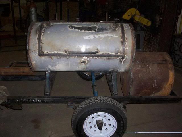

                          • #14
                            smoke
                            Here's a BBQ/ smoker that I built in my spare time. It's made from a 120 gal air tank, 1/4" plate steel from a demolition company. I have about $150 into it. I had a 125lb pig cook in it over the summer. Watch for more of my projects. Keep it simple and cook it slow. Here are the pics
                            • #15
                              Very nice Vitler!! I'd do a number of things different with mine, but for now I guess I won't argue with results. Besides, if I start another one now, I'll probably have one unhappy wife!!!!
