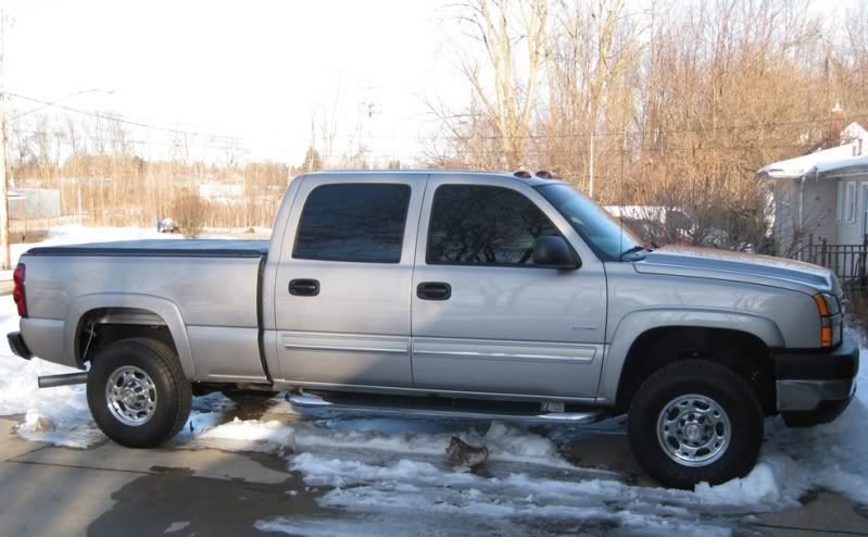

                • #38
                  Originally posted by Vulcan Man View Post
                  Dont know which I like better,the trailer or the truck. Great job on both. I love a project with pics from start to finish. Nice welds on the trailer BTW. What year is your Z71? I have a 99 model.
                  Z71 is a 1997, and was delivered to its new owner yesterday. It was a great truck, especially considering how I abused it. But at 13 years old and 170,000 miles, it was time to let it finish out its life a little more leisurely. Here's the new tow rig.
