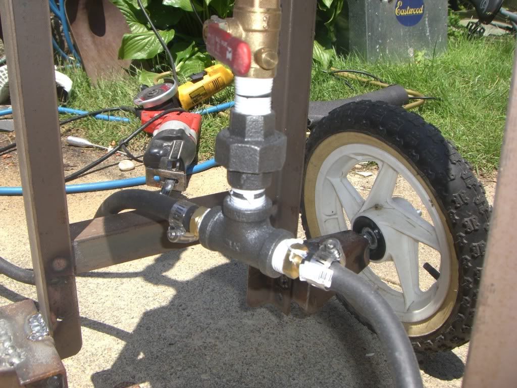

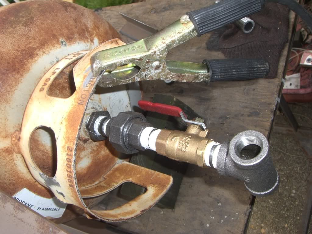

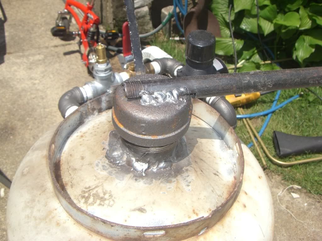

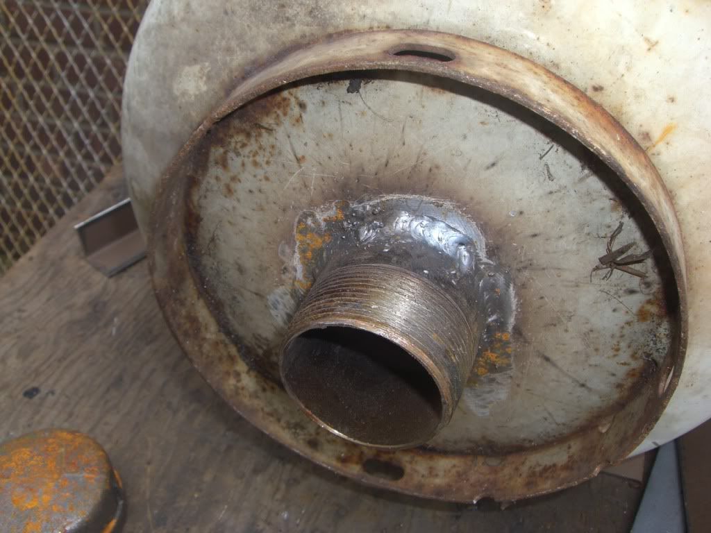

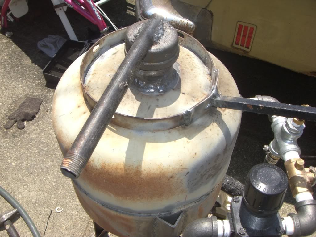

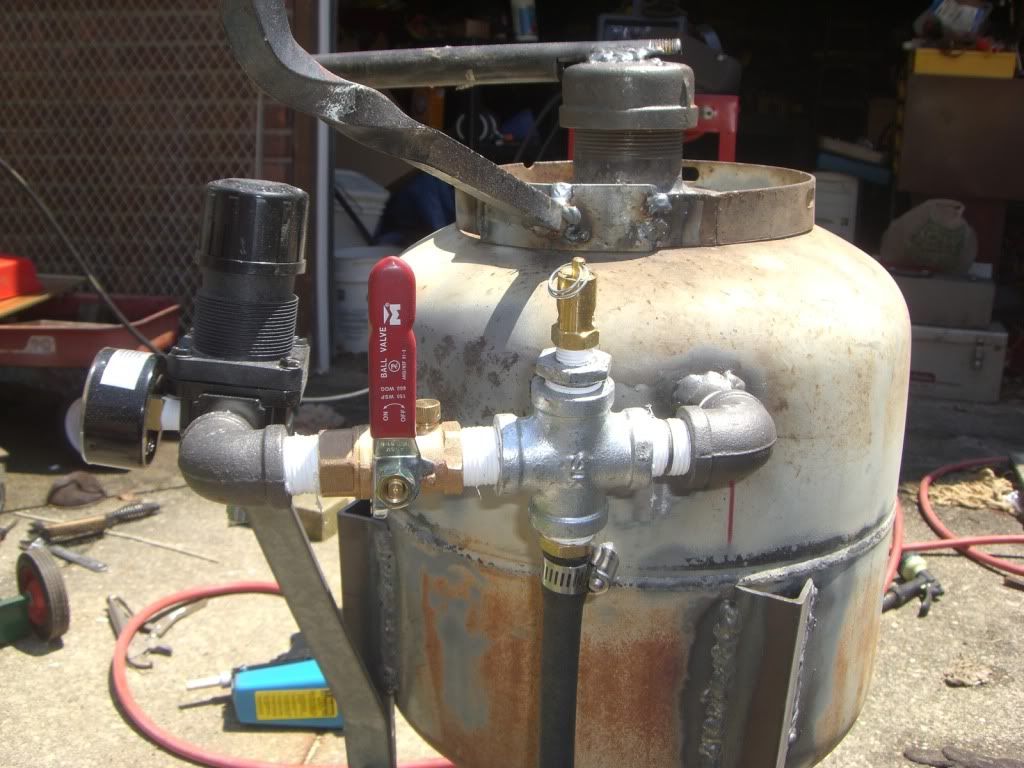

        Cool idea. I do not really understand the large top fitting though. Is this just a cap to fill it (what size is that NPT). Also why do you "T" it off and run a hose to the bottom "T". Is this how they are supposed to be. Is this just to induce air into the sand at the bottom "T". Also what is your safety blow-off set at. I might make one.
        T.J.
        Miller Dynasty 300DX
        HTP MIG 240
        HTP 380 Plasma
        Bridgeport Milling Machine
        South Bend Lathe
        Etc. Etc....
        tjsperformance.com
        • #5
          Yeah, that is 2 inch pipe cut off for a filler hole. You use a funnel and pour your media in then cap it tight, using a piece of an old innertube as a gasket.
          The air enters the tank above the media (sand) and forces it down and out the bottom, while at the same time, an alternate path of air is routed down outside the tank and then joins the flowing sand at the "T" fitting. This keeps the sand moving with required pressure.
          I put a 125 PSI safety valve for a safety blow off. My compressor just about reaches that pressure, and i use the plastic regulator to keep below 100 PSI. Since the photos, i replaced the washing machine water hoses with real hydraulic hoses i got from the Northern Hydraulics catalog. The blaster works excellent. I used to have a siphon type toy from Sears, It always clogged up and generally sucked. But this thing just blasts away rust and paint at an unbelievable rate. I use Black Beauty Abrasive, and i don't choke on silica dust anymore. This is one of the most useful projects i have built.

              To add to the OP's explaination -- the valve under the tank is only opened part way to regulate the amount of sand that comes out. If opened all the way you usually get way to much sand. The valve on the end of the hose (where the sand comes out to blast) should be opened all the way or it will have a short life as the sand will wear it away quickly if used to regulate flow by leaving it part way opened.

                nice looking blaster but if you you use it a lot it will wear through the t fitting on the bottom, on commercial unit the t is actually a 4 way fitting with a plug in the bottom so there is more material there to wear.

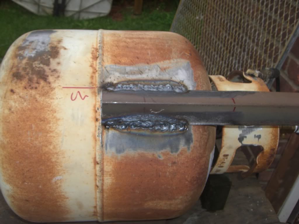

                  Nice project Jonh and it's a good size for portable and small job. A use to be a sandblaster my self for 5 ears, 7 ears ago whit industriel big stuff!! Your kit is very cool , and y see that your a welder debutant seeing your welds

                    To add to the OP's explaination -- the valve under the tank is only opened part way to regulate the amount of sand that comes out. If opened all the way you usually get way to much sand. ...
                    Thanks for clarifying that point. You are completely right. if opened up too much, the blasting nozzle loads up with media and you get a real sh1t storm out of the nozzle when you hold the deadman lever, and a mess to clean up in the driveway.

                      Indeed i am. if i was younger, i would have been embarrassed to post the photos of my crap welds, but at this point in life, what the h e l l. if somebody could get an idea from the photos, great. I haven't touched a welding machine in over 10 years. i just retired from a hectic public sector job that kept me busy for years. i am finally getting around to doing the things i used to like to do in my free time. i picked up a 1988 jeep wrangler that needs a bit of welding, so i will get a bit better hopefully when the weather improves here in NY

                        Practice, settings and seat time Joe...

                          Nice job JOE! Looks just as good as a retail unit. Keep up the good work. Darrell
                              hey, i made a blaster a few months back, it is similar to yours, the filler port is the same, 2" nipple and cap. how do you have the inner tube sealing the cap? could you take a pic? mines leaking, i tried a few diff ways to place the tube but it still leaks.
