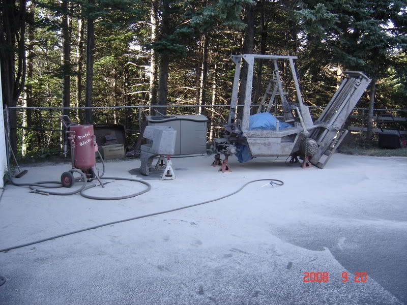

  • Sberry
    Senior Member
  • Sberry
    replied
    You probably wont like mine then.
    Leave a comment:
