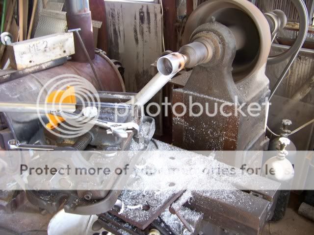

    with bolts.
    You reminded me of the old vice I have on my old horizontal mill.
    Somebody welded it and "sandwiched it"...quite crudely... but I use it and it works fine.
