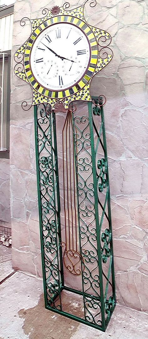

    This was a fun project...I bought a clock face from Sam's Club amd built this stand for it.

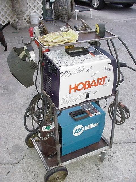

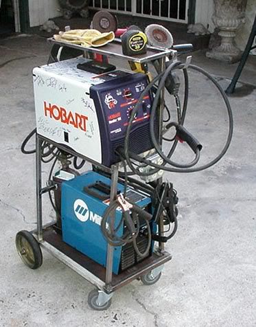

    For a little more advanced folks, you will want to build welder cart. Here's one I built

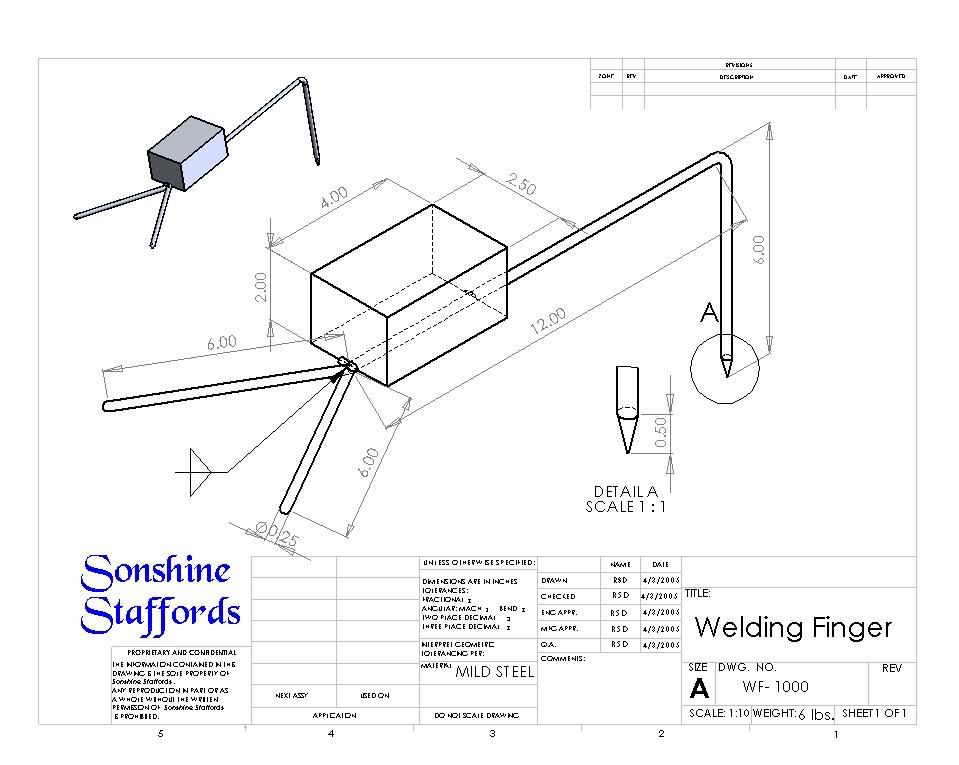

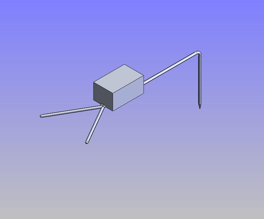

    A simple project for the beginner weldor is a "weldors finger". It's a hold-down device for small details when you're doing bench work.
    Here is a drawing:
    Enjoy
