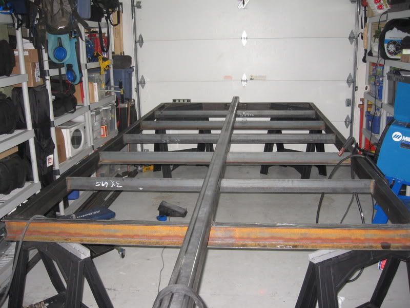

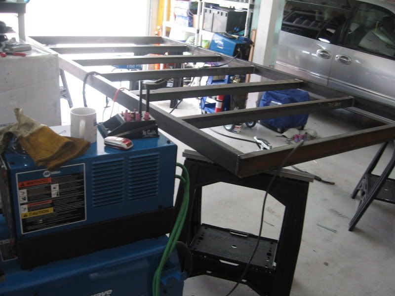

    this is what i am working on its a 6x12 single axle 3500 i got the plans and can email you them if you would like.

            Dave, thanks for the info. I was going to use 3" channel x 3/16" for the tounge, since my last trailer recived a bent tounge from my brother in law, due to placeing to much weight forward. This is what I ment by over build, and I agree with your policy -"You break it, You pay to fix it". I was just trying to avoid the aggravation. I like the pictures of your trailers, this gives me some ideas to add to mine if I can find a better price on steel. I did by my axle from RedNeck, $92.00 for a #3500 with leaf springs and hardware; a friend has an account with them. Also, I priced the steel locally, about $600.00 . By the time I purchase all the parts, I will be over what I could buy an already made trailer - $850.00, but not built to what I want. I have to call around and check other suppliers. Thanks for the help, keep it coming. I will check with the web sit you mentioned about those plans.

                Bert, I don't see a need to over build anything, If they are gonna break it they are gonna break it. When I build a 3500 lb. trailer it is rated for just that, if the owner overloads it and it bends or breaks, how is the liability on me?
                A 6'4"x12' trailer being built with 2"x3"x3/16" angle for the frame and 2"x3"x11ga. box tube for the tongue, 1 1/2" angle for the uprights and perimeter rails, and decked with 2"x8" or 2"x10" plank boards is more than sufficient. Building with these materials the empty trailer weighs in at about 480 lbs. Leaving you with a payload capacity of 3020 lbs.
                When you build the same trailer using 3"channel you now have a trailer that weighs 640 lbs. and a payload capacity of 2860 lbs.
                How did you gain anything by over building it, you just spent alot more money on materials and lessened the payload. Another thing to note, Trailer axles and springs are rated at about 85% of their actual capacity, so if it is overloaded to the point of failure, it's the owners own gross negligence.
