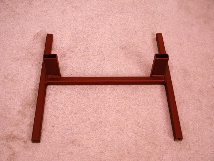

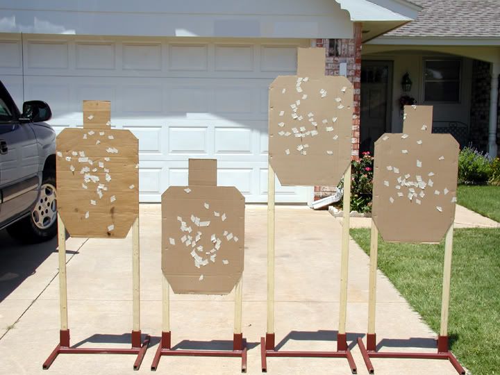

            These are the ones I have built. They are super cheap, easy to store and handle, and work great.
            • #7
              Target frames
              joozy,
              I build target stands for our gun club similar to liliysdad's stands. The big advantages of this design are, the vertical frames that holds the target are 1"x2" strips of wood. If you shoot the frame, the bullet will go through the 1"x2" and not bounce back toward you like it might if the frame was steel. If you hit the frame several times, you only have to replace an inexpensive 1"x2" strip of wood and not a steel target frame. You can attach any type paper target to the frame with a hand held staple gun, at any height you want, which makes it quick to set up and change targets. The 1"x2"s will lift out of the bottom steel frame and both bottom frame and 1"x2"s will stack in the back of you truck or even your auto trunk. From the pictures liliysdad posted, I would guess he shoots USPSA/IPSC.

                I must make a disclaimer.
                The ones shown are not the ones i built, but are identical. I dont have apic of mine. The only difference is mine are black.
