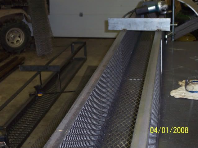

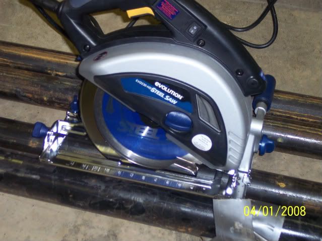

    I had to cut about 300 feet of expanded metal and was not looking forward to using my plasma cutter. I've seen these saws for sale but they seemed pricey and I was skeptical that it would do well. My LWS suggested trying this saw out and I'm glad I did. This is a great tool. I picked it up for $400 and it was money well spent. Adam

      Did you buy the Milsquawky "dedicated" cold cut, or just put a carbide blade in your go-roundy saw?

        I got the milwaukee 8" dry cut. It was $289 a couple years ago.
        The thickest I've cut is 1" and it goes a little slow on that, but anything under 5/8" is like cutting plywood.

          I have been skeptical of these since I first saw one four years ago. What a nasty mess it could be if it fed back...? Or maybe I'm just being too paranoid?

            I was worried about kickback also. The blade cuts in a fwd/up motion and it never jumped once. Definitely don't want to try it single-handed though. It's heavier than a regular saw. It also collects a lot of shavings in a removable side compt. Adam

                        New Toy
                        Is that a pipe track or cutting guide in your first picture? If so, do you have more pics and detail? Otherwise, does anyone have a cutting guide for extra-long cuts (other than just clamping a piece of angle or channel)?

                          I used one of those to cut AL and I was disapointed. It sucked because the main part the saw slides on across the metal kept digging in and would not slide across it smoothly.
                          I did try it on MS and it worked very well.
                          • #14
                            The milwaukee's baseplate is stainless and very smooth.

                              You can tape or clamp a strip of Formica to any metals being cut that you don’t want to be damaged. Chips will get in between the base plate and metal and trash the finish even on plastic covered metals. Formica is nice and slippery and the saw will glide. Formica makes a good "folding" straight edge too. You can roll it up a 120 inch long 6 inch wide strip and tape it into a 2 foot loop. If you want to use it as a saw guide you need to add a thin strip of alauminioum angle to your saw base plate and let the Formica ride over the foot and run on the vertical leg. Two threaded holes to mount the angle is all you need. One strip under the saw, one as a guide and roll them both up together when done.
