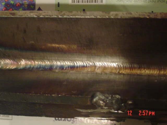

    ok thought i would give u guys a laugh, here is a pic of my first welds...
    i numbered them as i had done them...
    the pieces were 1/16" angle iron..
    1-4 i had the machine set on auto-set .030 wire, and the thickness set to 2.5 which is in between 18g and 20g.
    5-7 i turned it up to the high side of 3 which is the high side of 18g.
    7 i tried butt welding 2 pieces, and while it was strong, with enuf beating it on the saw horse it eventually gave.
    i will say tho it was cool to have that kind of power....
    i had tried a thin piece of 16g sheet, but i kept blowing through it no matter how low i set the machine while on auto-set.... guess i was going to slow.
    ok u may laugh at me now.... lol

    do you have the MM180 or MM140 ?
    16gage is not so bad but on thin stuff ya need to stick to small runs, like 1" max then move and do another to keep warp-age down and stop the burn threw. as you go the part builds up heat so it tends to blow threw just about the time yo get a good bead running.
    work on keeping a constant distance (stand off) and speed. you can back the torch away a bit to cool it at times if needed. just don't forget about warp-age on long runs. in time you will start to pre-think the warp and can use it to your advantage or prep to accommodate it.
    melting steel is great fun. don't worry the welds will get better.
    P.S. always clean a spot for a good ground.

          Ratt:
          Congrats on your MM180. You will never be sorry.
          If you're not, use two hands to hold the torch. Slow down, I think you're going too fast. Use a soapstone line, it's visible and will help you go straight.
          fun4now: 16gage is not so bad but on thin stuff ya need to stick to small runs, like 1" max then move and do another to keep warp-age down and stop the burn threw. as you go the part builds up heat so it tends to blow threw just about the time yo get a good bead running.
          F4N just said more in 2 sentences than you'll learn in the next year. I think .023 is a better choice for 16ga.
          F4N: work on keeping a constant distance (stand off) and speed. you can back the torch away a bit to cool it at times if needed. just don't forget about warp-age on long runs. in time you will start to pre-think the warp and can use it to your advantage or prep to accommodate it.

                      I guess Ill show off my welds as well. This is my first run and crack at Tig.
                      Sorry about the fuzzy pictures. I was told I could weld, but suck at working a camera .

                        Keep welding.
                        Looks like a good start! Nothing to laugh at! practice, practice and practice. And when you're done practicing, practice some more!

                          First at TIG, but have you used any other process? I hope the answer is yes, otherwise I'm going to have to slap you silly.
