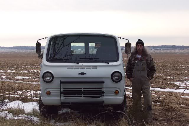

                        • #13
                          Originally posted by mudsplasher View Post
                          Here is a rough sketch of a type of grill guard that I have made in the past. I have 4 bars in this one, but three actually looks better.
                          Made one just like that for my 4x4 van.
                          • #14
                            I have to get the bill paying work done 1st.
                            seems like thouse stinking bills are always getting in the way.
                            puddle jumper
                            now thats a VAN !!! i like it. did it start out as a 4X4 or is that your doing? i realy like the old chevy vans like that. that or an old V-Dub would be the oly kind i would consider having. the wife would of corce cover it in flowers!!!!!!!! 8^() aaaa what ya going to do? they say ya cant kill em.
                            nice front rack, clean and simple.cool.

                            • #15
                              Van
                              Nice Van, the guard in front really looks good!
