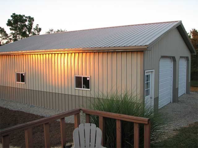

            Hey Bulldog,
            That's some fine workspace you're making there.I just had a 30x40 shop put in and I have a couple of questions if you don't mind.
            Did you run electric from the house or did you go with a separate meter? If it's from the house, what size wire? What size service to the shop?
            How long before you could run the forklift on the new concrete?
            I have 1/4" R7 insulation between the sheathing and purlins, but nothing on the interior walls. I like the finished walls you have, how are they insulated if at all?
            Sorry for all the questions from a noob, but I'm really impressed with how you've finished things off
            My shop:

              Hey Chris,
              NICE shop!
              I ran the power from the house. If you look back a couple of posts you'll see a pic of the line coming from the house. It's inside a white pvc pipe. I ran a 200amp service into the shop and had to go with 4/O cable and I brought over a #2 ground. Around here your only allowed 1 meter per lot. The service was alot more money then I had expected. The cable alone was about $800.00. Thay aint given that stuff away. As far as the concrete goes. I put in 12" of stone and 6"-7" of 4500 psi concrete in. I kept the shop at 50 degs and kept the humidity at about 60% for 1 full week before I did much in the shop. I did run my Kubota on it but I didn't run the fork lift on it for a few days after that. I used double bubble insulation in the walls, and above the ceiling it's rated at R11. I also taped all the seams with that foil tape. I put the insulation on the inside of the outside perlins so I can blow in some celulois if need be. So far it's been pretty good.
              If you have more questions ask away. Let's see some more pics of your shop.

                Thanks, BD
                We had to dress up the shop a bit as we're in a residential area. There's not really much more to it right now, it's mostly storing equipment for my tree business. I'm waiting till spring to pour the floor because the back end sits on top of 36 triaxle loads of fill All moved with my Kubota about the size of yours
                I'll probably run 100 amps out there from the house. It's mostly going to be repair/storage space for my equipment so I think 100 will be enough. Obviously I don't have the electric run that you do as that pic was taken from my back door. Thank goodnes with the copper prices these days.
                Wow, that's one substantial floor! With the projects you do, I'm sure you'll be happy you went with the 6" thickness. Thanks for the timeline.
                I'm going to call the builder and see what they recommend for the interior walls with the insulation setup I have. I really like that look (the internet is always costing me $$ )
