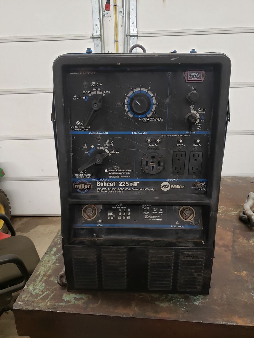

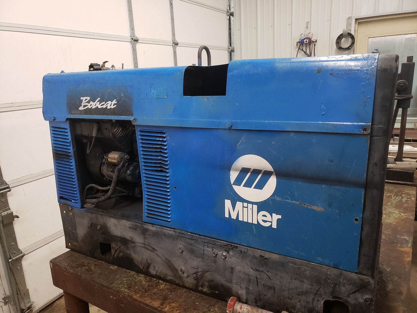

    i have recently Bought a Miller Bobcat 225NT Propane setup. I did hear it run the Guy was a bit of a Jerry rigger and i want to make this thing back like new again. I cant find anything about this propane setup from Miller as to whats missing or not Any help would be greatly appreciated also looking for new engine harness
    there was no regulator on the bottle just a ball valve

        I have no idea what you consider "Jerry Rigged" on that machine. It does appear somebody wired around the Murphy switch for low oil.
        The machine has a vaporizer and solenoid on the propane circuit, similar to my Onan driven propane Bobcat.
        Your mention of no propane regulator on the tank indicates you NEED to do a lot of learning on how Propane functions, preferably before you get hurt.
        Why the solenoid is wired to something inside the fan housing baffles me. Only possible in my mind would be an engine rotating switch for safety to shut off the propane if the engine stops for some reason.
        Good luck finding information on Propane machines from Miller ITW. They didn't make many and they relied on Kohler to document that end of the machine.
        BTW, it WON't run on a BBQ tank and only MIGHT run on a 20# tank from a floor buffer. That machine requires a forklift model 40# tank properly oriented to deliver liquid to the machine.

            That is why i am asking. Do you have pics of yours so i can see whats missing?

              What I'm reading is you bought something you ain't qualified to run.
              What I see in the pic is a propane conversion kit installed by a halfwit.
              Look at the vaporizer and pulsator for nameplates and model numbers.
              The components are there to make it work when connected to a liquid delivering propane can.
              Judging by what I see in the pic the genius who hooked it up probably didn't use propane rated hose.
              Figure that out, replace the hoses as needed CORRECTLY so the machine don't catch fire.
              Where and how do you intend to rack the liquid tank?
              ​​​​​​​Better question, where do you intend to keep the fire extinguisher handy?

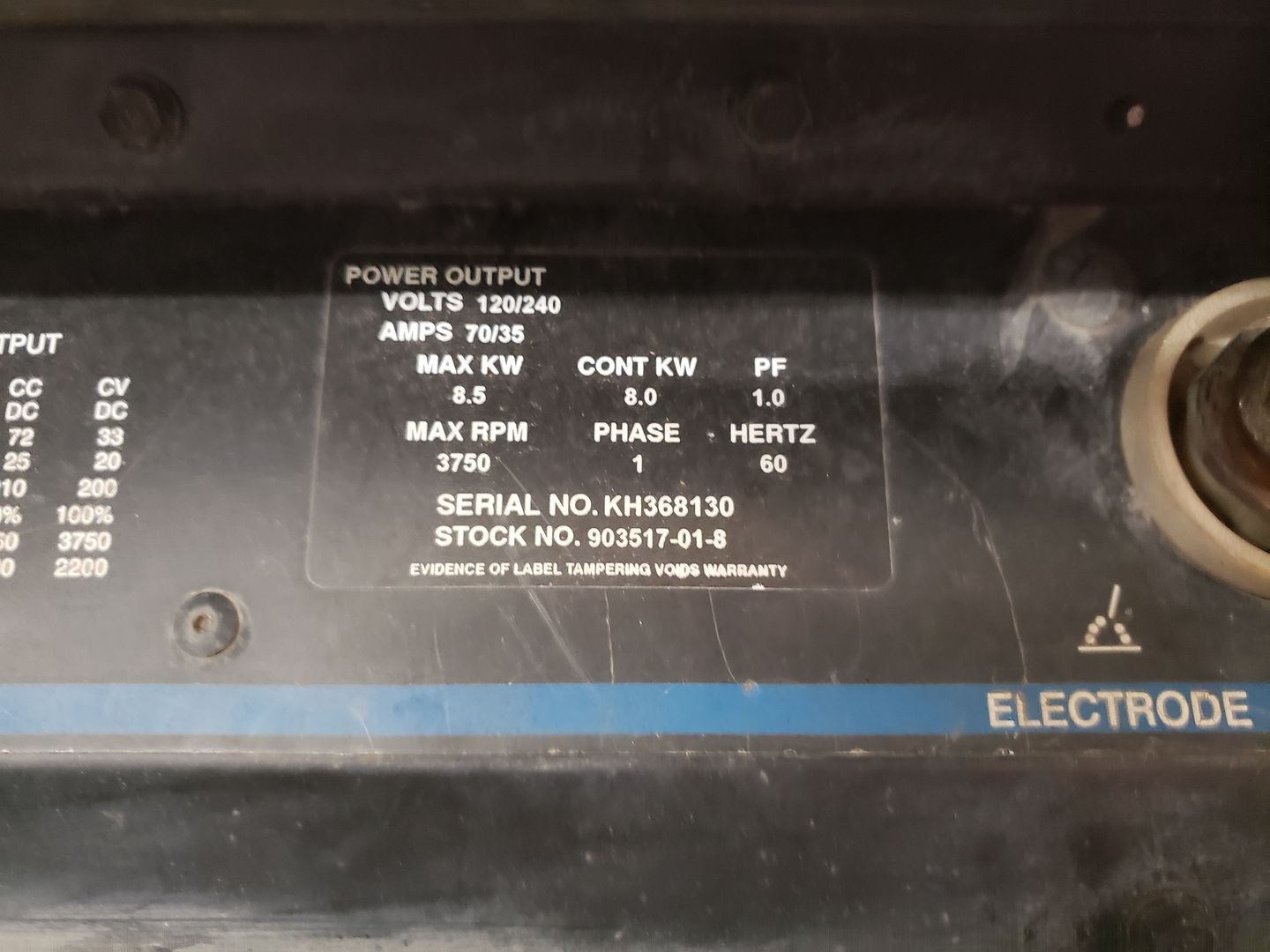

                      You are not going to find anything on the propane set up in Miller books. You need to find the spec # on the silver tag on the side of the engine and go to Kohler. I haver a used stock evaporator and regulator for that machine. Those 2 parts run about $900 new. As far as the wiring I see, he replaced the blocking diode but didn't tape it back up

                        I have found the Kohler parts list with the vaporizer,Regulator and carb but it doesn't show the supply line from tank to solenoid
                        also Do you know the part # on the blocking diode or size for replacement so i can repair the harness
                        • #13
                          The diode is 070250. I think the last time I ordered the hose from the bottle I had to call Miller Service.
