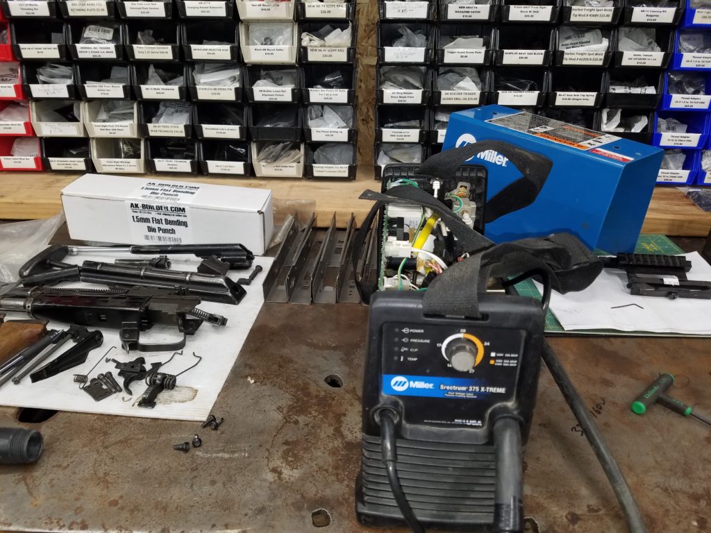

    Anyone have a Service / Tech. Manual or Board Schematic For a Miller 375 X-TREME Plasma? Serial Number Range: LG130001P through LG190233P
    Need to Get the Value of R123 a Ceramic Power Resistor.
    Will be digging further but just removed the parts that had a visible catastrophic failure / damage
    Will Still need to find the failure that caused the Resistor to Go Nuclear!
    So Far My Parts List
    2 X 1500UF 250V Caps
    1 X AVX FFB16J0395K 3.9uf 525v Capacitor
    1 X Unknown Ceramic Power Resistor
    Pulled the Heatsinks and Don't Look Like any of the Transistors Melted Down..

              Need to remove the Plastic Cover From the Board So Removing & Checking The Transistors..
              Waiting On Larger Nozzles for My Desoldring Gun.. Wish I had a Hakko Stocking dealer here.. Seems Like Motion Industries has Purchased all the cool stores and nixed all the good stuff!
              All the IGBT's Seemed to Check Out With Multi Meter.
              Negative Lead on Collector Posotive On Emitter Open.. Touch Gate With Posotive Lead Will Tone ON Emitter/Collector, Short Emitter and Gate = Collector and Emitter is Open Again.
              Data Sheets For IGBT's
              X 4 https://www.mouser.com/datasheet/2/1...pd-1225850.pdf
              X 1 https://www.mouser.com/datasheet/2/1...bf-1227630.pdf
              X 2 https://www.mouser.com/datasheet/2/1...d1-1225219.pdf
              That Lacquer type Coating on these board becomes a mess.
              The 2 Transistors I Marked 10 and 11 are DSP45-12A Rectifiers That is Were The Traces Go Will Know More When I Remove them all and get that plastic Cover Off.
              Should have my 1.3mm and 1.6mm Nozzles By Friday. Found the solder wick but with that coating PITA..
              So Far Only Transistor I Cannot Identify Miller Part Number.. 5 Pins..
              My Other Gun's
              So Anyone With A Board Schematic Would be Much Appreciated. Otherwise I Will Prob Disassemble this Entire Board hahahah!

                I got the board schematic.. it is on my personal blog.. Now..
                Whats Under The Hood.. So far No Bad Parts.. Except the Relay and Resistor.
                So All Burnt Parts, Replacements On The Way Prob Tuesday/Wednesday. Including that HX50-P Prob Still Good But it is Burnt..

                            Miller and Lincoln do not use OEM parts, that is, all parts can be found say at Digikey or Newark. Now pulling board parts is generally not the answer. Least wise without a Huntron scanner. Most machines are pretty simple to locate the problem anyways.
                            • #15
                              I've repaired dozens and dozens of miller boards, if you put a little MEK on the board and let it sit for a while, it depends on the type of conformal coating used at the time, then blow it off with compressed air it will remove the conformal coating and the de-soldering goes much easier and cleaner.
