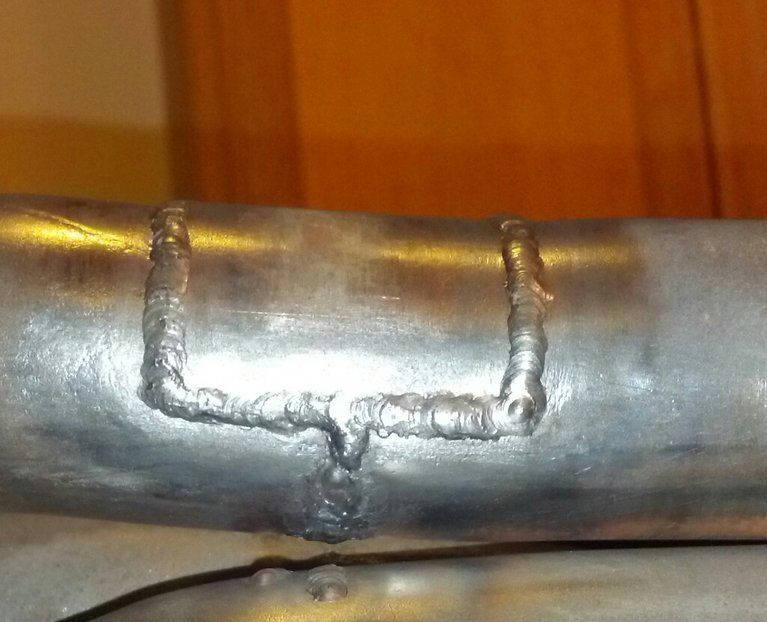

          All comes to worse, use my "window" technique. Cut out a window, weld the backside (that is unreachable from the outside) from the inside, then weld the window shut in place.

            I made those headers like 5 years ago, so yea they're ugly, lol.

                The window technique is interesting, . I need to run a bead of weld around the rotted out manifold to EGR tube fitting. The tube is only about 3/4 Dia. Problem is there is no real clearance between the tube fitting and the head (at least not enough to get a good angle on it). Im not sure I have the room to cut out a usable window
                I might have to dig out the stick and bend a rod to work, or worst case try to gas weld it.
