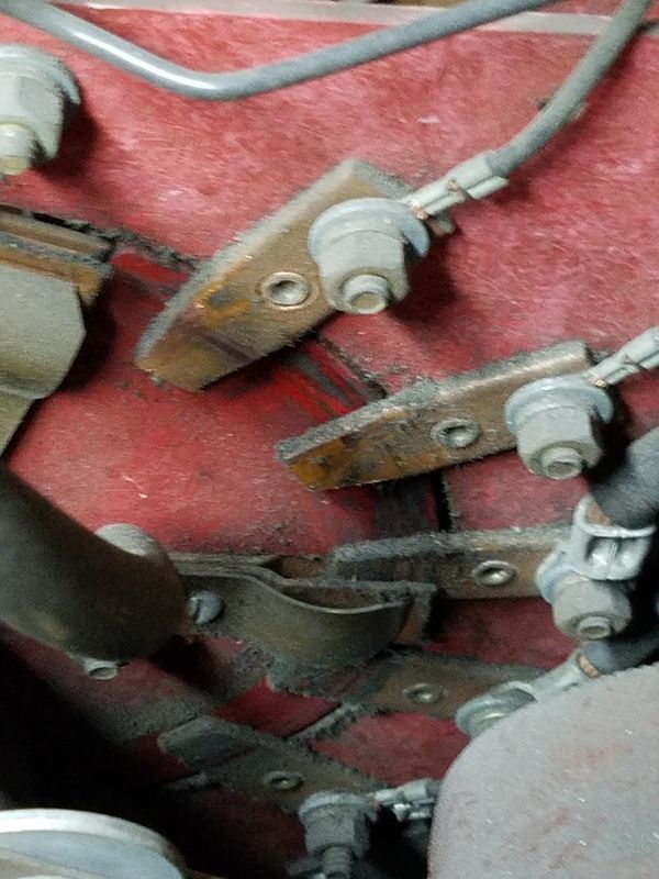

    I have a 330 abp, I tried to weld with it yesterday, very low output. I noticed when I try to switch polarity there will be sparks coming out just behind the lever. I had a lightning strike a tree about 75 feet away, from my house that still took out one of my TV's, antenna amp, modem and router. I wonder if this can be related. It was working flawlessly before then. I have the manual and parts drawing, looks like there switch plates inside, anyone ever take one of these apart, and do they still make parts? its a '86 model. Thanks.

            • #7
              Took the cover off, definitely sparking on the contacts when going from DCRP to AC, also when I turn the range selector to high it sounds like its under a load. I have a line on another 330 for a hundred bucks, may just get it, its a lot older though, 74 model. Here is a pic, doesn't show much there is some corrosion on the contacts, something is definitely going on.

                • #9
                  Sorry to be so slow. Pretty complex machine (at least by old-time standards, but not like one of today's electronic marvels). Hope someone with experience with these machines will join in. In lieu of having someone who actually knows the machine, the first thing I would do is disconnect the remote if you have one, put the standard/remote switch to remote, and see if the switch still arcs. Going to "remote" with no remote connected should remove all power to the polarity switch. Unless the Lightning resulted in some things being connected that shouldn't be, there should be no power to that switch unless you're welding. Contactor W or its control circuits could be the problem.
                  • #10
                    Got into it a little more today, If you turn the machine on and its in AC, then move it to DC rev, the big contactor down by the transformer will engage like its under a load, if you switch the remote switch to remote, the contactor will release, then there are no sparks when you turn the selector or range switches. According to the diagram, I guess that would be contactor W.

                        • #13
                          Well I'm on the right track, had help from someone who said its probably a bad diode, pulled them out and sure enough, found a shorted one. Don't know if its the only thing but good to find something that is wrong. $67 on miller for less. Thanks, I'll update later.
                          • #14
