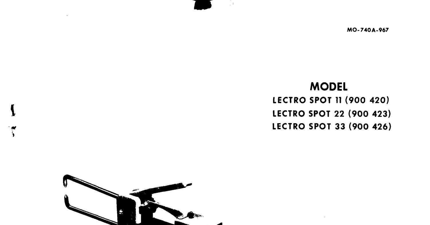

I have an older miller spot welder with the timer build into the body of the welder. Does anyone have a manual for this?
Older Miller lectro spot model 11 spot welder

The timer operates on cycles. I'm not sure if it is the same timer you posted above.
I called literature and they are going to look for the manual on microfilm as the manual is not posted on line.
The machine is rather old. I ran a test spot weld and did not get a good weld with new tongs. I would like to know what I need to do to clean it up and get it working at top performance.Attached Files

MO- 740 A-967. MODEL LECTRO SPOT. OPERATING. (900 423). LECTRO SPOT 33. (900 426). MANUAL. ELECTRiC MFG. CO., Appleton, Wisconsin. ADDITIONAL COPY. PRICE 20 CENTS. LECTRO SPOT 22. AND. MAINTENANCE. miller. 11(900 420). I. ...
Here is a link to the manual that mentions the two vacuum tubes in the timer.
Both 6C4 Triode & 2D21 Thyratron tubes are still widely available.... but I would buy a few spares while they are...
Download and print that manual.....Last edited by H80N; 07-19-2016, 08:44 AM..

miller_130xp
I have a pdf of the manual for this unit but it is to big to post here so I would need to e-mail it. Please PM or e-mail me if you want it sent.
[email protected]

Originally posted by miller_130xp View PostI'm not getting a good weld on test sheet metal. The tongs are brand new Millers as are the tips. The sockets for the tongs are copper and have tarnish. Perhaps I need to clean the sockets to get a good connection? I have it plugged in with no extension cord..
For the sockets....could clean off the copper tarnish with some Lime-Away or CLR....(citric acid)... on a Q-Tip
then wiped off with a few Q-Tips with clear water... then dried offLast edited by H80N; 07-26-2016, 05:23 PM..

The tubes are not in the weld circuit directly-all they do is determine how long the contactor is energized to turn on the weld current. So, if the contactor (CR1) is clicking closed when you try to weld, the tubes must be OK. You've already addressed the secondary side of the weld circuit by cleaning up the tips and their connections. The only thing in the primary weld circuit is the plug, trigger switch, transformer, and the contactor. The only parts subject to wear are the contactor and trigger switch. I'm guessing the contacts may be worn or dirty on the contactor and not passing full current to the welding transformer primary. I suppose if one of the tubes is weak, the contactor may not pull in as sharply as it should; if so, that could in turn damage the contacts. I'd look hard at the contactor itself first. Also verify good connections everywhere.
