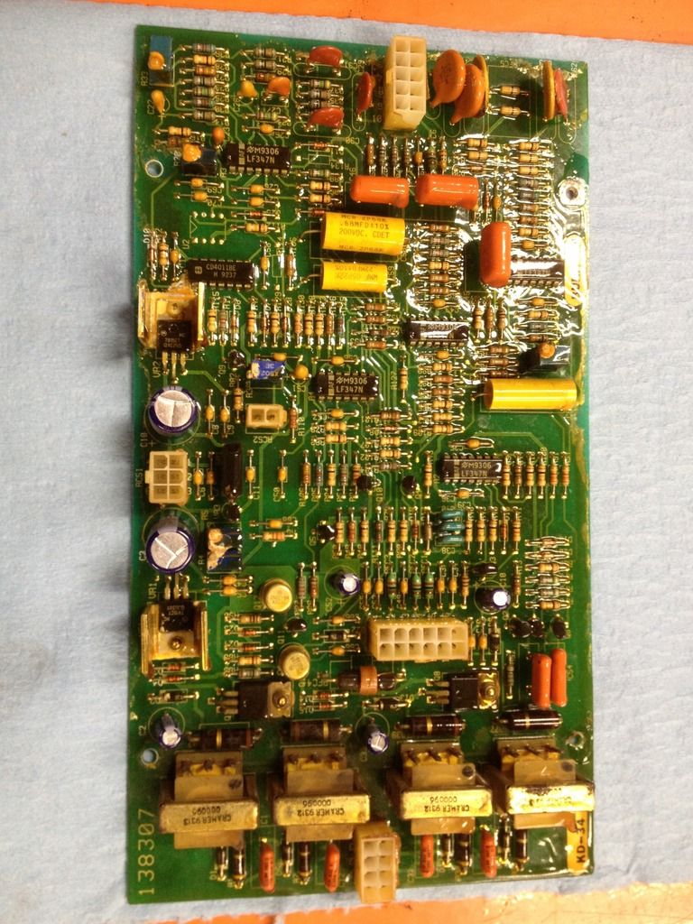

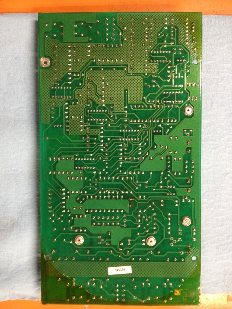

    I've pulled the covers, PC1 is clean and it is obvious the caps have been replaced. I took some pics of the board, no burned areas or anything that looks out of the ordinary, I'll post the pics later tonight. The rest of the machine is dusty, going to try to get it blown out tonight.

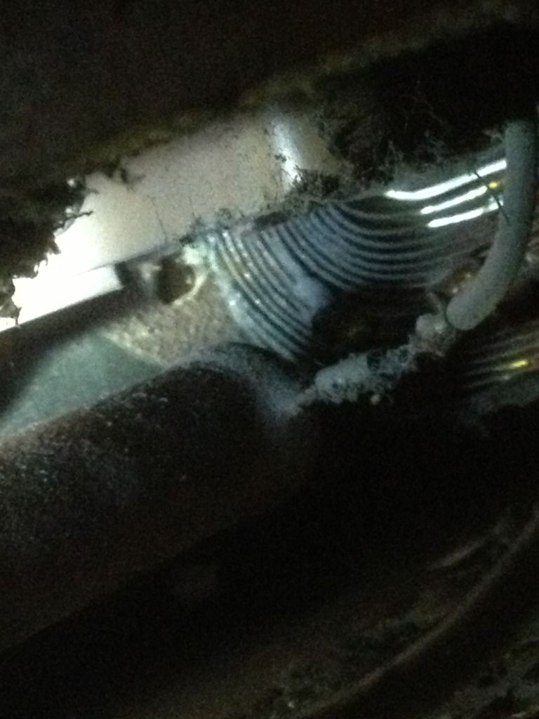

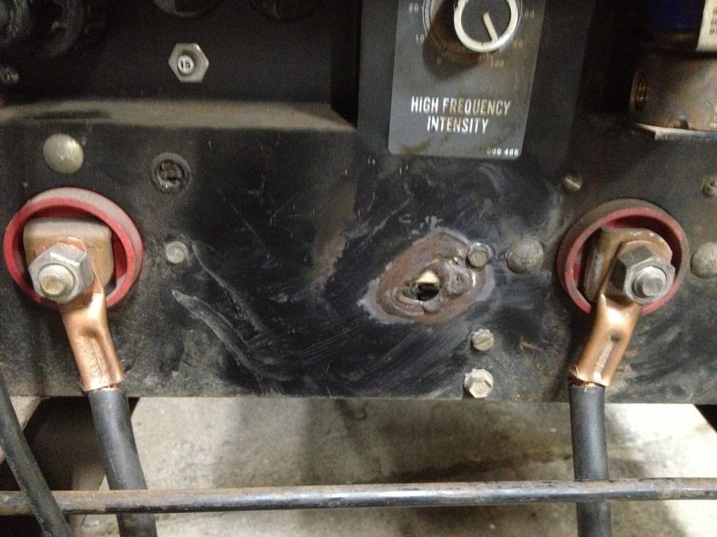

    I did notice that the work side terminal can be wiggled a little bit, not sure if that's normal or not, ground side terminal is solid and doesn't move. There is a small area about the size of a quarter between the work and ground terminals where it looks like the metal melted or someone tried to weld something to the machine, I'll snap a pic of this as well. Previous owner told me the machine was like that when he got it and it had no impact on the machines performance before the board messed up.

            Here are the pics of the board and the area near the terminals I spoke of.

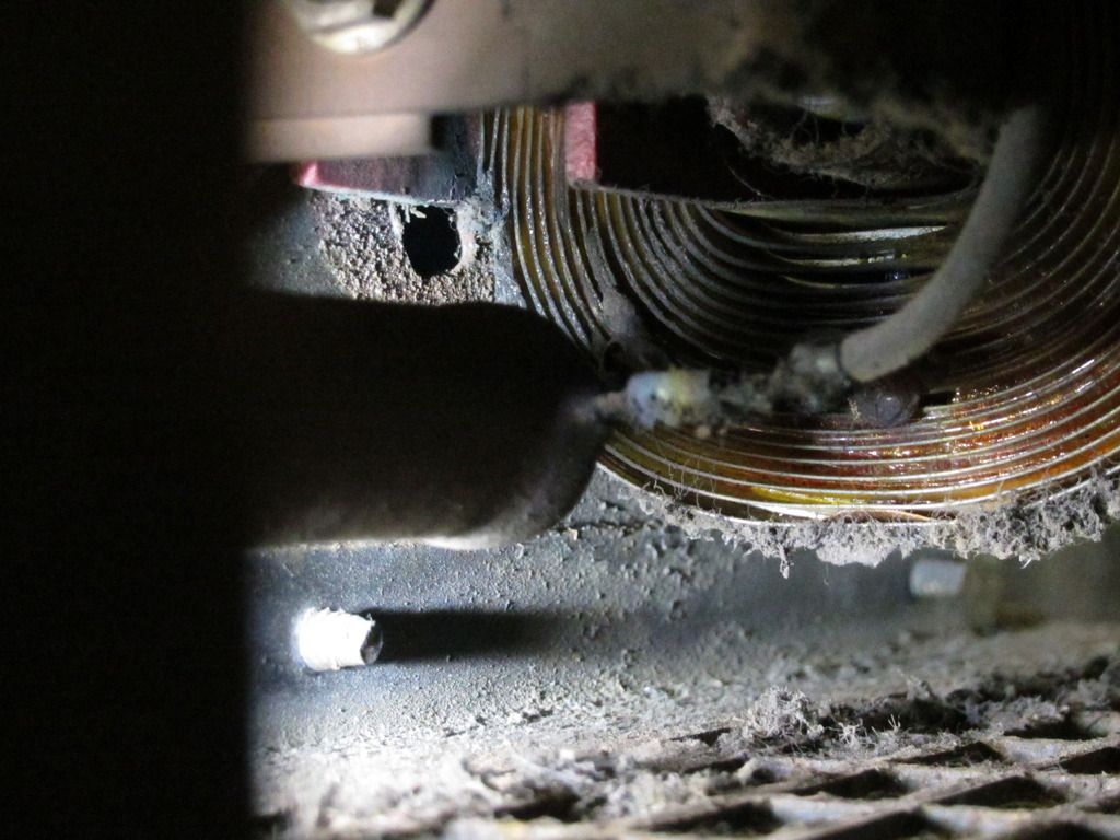

              Bumping this up and including a pic from the back of the damaged area, going to try to get a better one but this is the best I have been able to do thus far.
              Any other suggestions on trouble shooting this thing?
              • #8
                Is that some sort of coil just to the right of the hole? If so, it's toast. The outer 2 or 3 windings are melted together, and maybe more up under the sheet metal that hides the rest of it.

                  Ummm, that board has NEVER been to a capable repair shop. The Capacitor install, solder joints are hidious. Besides those Caps would not hinder the pulse transformers from firing. (4 square things on the side)
                  Quite likely a board issue, best to shoot it over to PLC.com, explain that the firing circuit is not working.

                    The last pic(from my manuals parts list) shows to be part number 124 650 (Coil, HF coupling).
                    I felt the soldier job was a bit shabby as well.. I'll check out PLC. I was really hoping the board wasn't the issue being as it was sent out before.
                    Here is a better pic of the coil.. I tried to find it on miller4less but the part number must not be valid anymore.

                      Thats not the cause of your problems , so based on what you've told us, it all points to that board being the culprit. Its highly unlikely that board was sent out to any qualified shop. Replacing caps would NOT have been an issue on the pulse transformers firing or not. Possibly erratic, but the unit would have still worked
