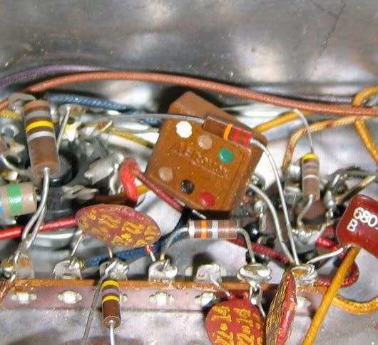

  • Aeronca41.... think we are both also experienced (old..??) enough to have learned the color code jingles for resistor stripes & dot colors for "domino" mica bakelite caps
    remember
    B-B-R-O-Y-G-B-V-G-W

    • ok, now you're just showing off....
      ...old guys...uh hem, I mean, distinguished gentlemen.
      • Originally posted by ryanjones2150 View Post
        l

            H80N,That pic of the mica cap did dredge up old memories. I think I still have some of those in the drawer next to 50 year old Sprague Orange Drops. And I still have my old Allied Radio (from their first instantiation before Radio Shack) book with all the handy color codes, wire tables, and even tube characteristics.
