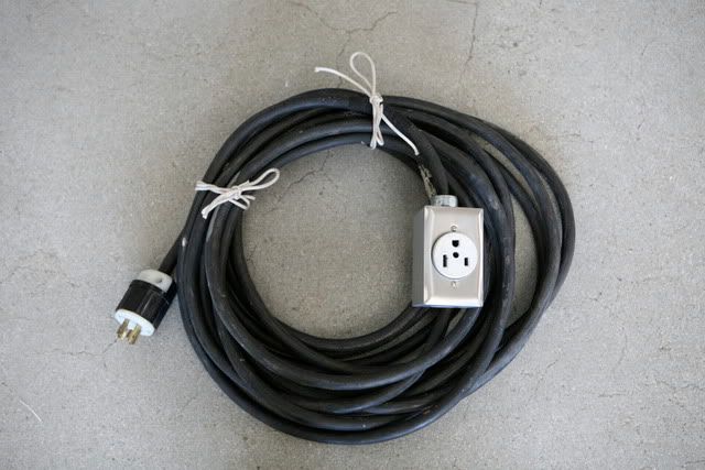

    Hello All- First post, be gentle.A couple days back we lost power to our home and I picked up a generator because we were going to be without power for a few days. In other words, I bought an item I have long been considering, but had to do it out of desperation rather than after research.I have been wanting a generator for two reasons: 1) emergency home power, and 2) for a mobile welding setup. Now that the emergency has passed, I want to get this forum's input on a generator I can weld with (the generator I bought is defective and is being returned). I have a Millermatic 175 240v which I use for repairs, projects and some artwork. I can MIG weld 1/4" with multiple passes from house power, but do not (necessarily) expect this from a mobile setup.Where do I need to start in terms of generators? and please remember this is also intended for home emergency power.Thanx for any input.

    That welder wants to see at least 20 amps 240vac steady state and 30 amps start/surge
    See page 17 Section 4-9. Electrical Service Guide For 230 VAC Model

      I am looking at running the home essentials, the whole house power puzzle is saved for a later date. The being-returned generator was a 5500W and it was fine for all I needed. The initial generator I am looking at now is a Generac GP5500. The 5500W generators seems to be the point at which prices rise dramatically.

        Should run your MM175 just fine... Generac is a quality outfit and tends to under rate their equip... so you should have enough headroom for the start surge...

          Whoa, just saw this: http://www.homedepot.com/p/RIDGID-6-...500P/205345096 1000 more watts at about the same price point, PLUS it has a 4-prong 30A 240V circuit.

              Hmmm, worked for me, try this:http://www.homedepot.com/p/RIDGID-6-...210757&cj=true. Good question on the amperage, wattage is continuous 6500 so can I make some amperage assumptions based on that?

                  Looks like a decent unit
                  "this generator delivers 6500 running watts (8125 surge/starting watts"
                  The 4-prong L14-30 will make it a wee bit easier to connect to the house for back up power.

                    6500 running watts (8125 surge/starting watts)
                    420 cc OHV commercial-grade engine
                    Clean power is ideal for sensitive electronics; less than 6% THD
                    Two 120-volt, 20 amp (GFCI protected) outlets and one 240-volt, 30 amp twist lock outlet
                    Gen-smart display for monitoring essential functions including wattage
                    8-gallon fuel tank for up to 12 hours of run time at 50% load
                    Zero-gravity, hand-truck frame design
                    3-year commercial manufacturer warranty
                    Also has a Hz readout on the monitor.

                        Anyhoo- specs are good and the generators are being built a little better these days in regards to sensitive electronics.
                        The MM175 will be happy.

                              Thanx for all the feedback, especially the idiot-proof diagram Broccoli...
