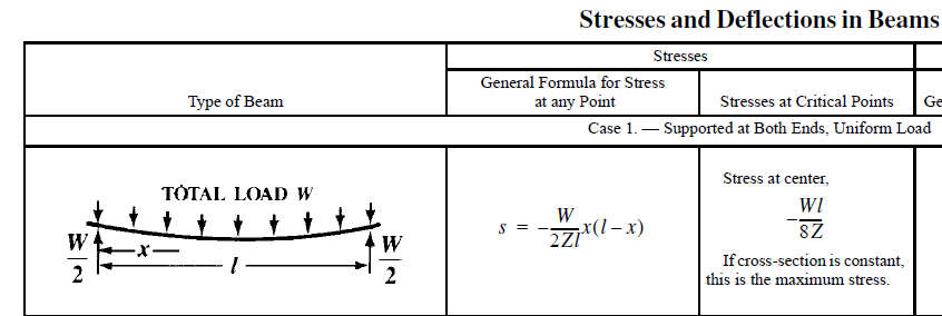

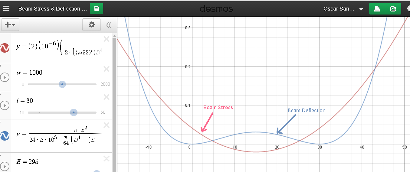

          • #35
            Originally posted by WillieB View Post
            I make the point often that well designed items exploit diagonal bracing, and place a weld not at the center of a member, but at its end where stress is at its least.
            You'd be surprised. For beams with rigidly fixed ends, beam deflection peaks in the center for uniform loading, but the stress is actually greatest at the ends, even though they are immovable.
            Here is a stress/deflection graph of a 30in hollow circular beam, uniformly loaded along it's length, rigidly supported on both ends.
            • The deflection curve has units of inches on the X-axis from 0 to 30, and units of inches in the Y-axis directly reflecting actual deflection figures (in this model at least)
            • The stress curve has units of length just like the deflection curve, but the Y-axis has to be scaled down by a factor of 2E(-6) in order to be visible within the plot window along-side the deflection curve
            • Notice how even though maximum deflection occurs in the center of the beam, the maximum stress "felt" is at the ends of the beam (at "0" and "30" inches, the ends of the beam)
            Note: Even if the material Yield/UTS/Young's Modulus is changed, the fact remains that the equations describing these phenomenon remain unchanged---the stress curve remains parabolic in shape, and the deflection curve is still 4th-order Quartic. Parabolic stress necessitates relative maxima at end-points, quartic deflection necessitates zero deflection at end points and a relative maximum in the center (for uniform loading).
            Basically, for uniform loading, the deflection along a beam does not always dictate the relative stress at those same points.

              • #37
                Originally posted by ryanjones2150 View Post
                That's funny, I was just about post that exact thing. Weird.
                I suppose great minds think alike
                Also interesting to note that [in this particular scenario] the stress curve has two roots (solutions on the X-axis) that correspond to zero stress. Of course the reality is that a mathematical model can only approximate true reality, but none the less there are two points on a rigidly-fixed tubular beam that experience almost nil stress, which is a consequence of uniform loading on it.

                • #38

                  • #39
                    alum weld help
                    Ha! But do you have a graph to prove it?!
                    • #40
                      Way too complex a graph for me to understand, I suspect you intended it to be. I do know a plank supported on two sawhorses one at each end, loaded with bricks until overloaded to failure, won't break at one end. It'll break near the middle.
                      No, it was not intended to be "too complex to understand". Just a visual representation of the bullet'ed statements regarding stress and deflection.
                      A plank on two sawhorses is a different scenario where a beam is simply supported from underneath on both ends, not with rigidly fixed ends. That scenario does not apply to a beam with rigidly fixed ends, which is what diagonal bracing would be. Correct, a plank on sawhorses will break in the middle with enough load, so long as it has a constant cross-section:
                      Rigidly clamp the ends, and it changes everything. Which brings us back to exactly what 'diagonal bracing" would be considered. The member acting as a diagonal-brace is a beam with rigidly fixed ends, hence the "plank supported on sawhorses" analogy does not apply.
