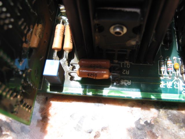

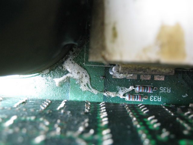

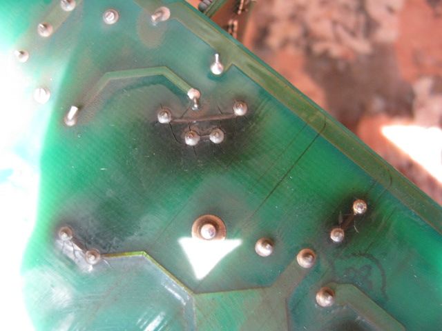

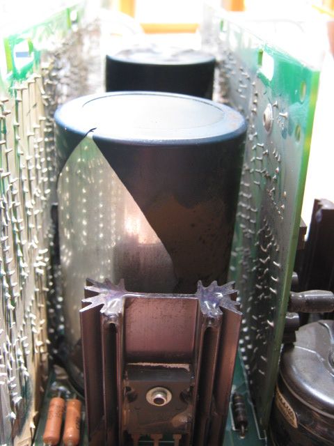

        • #5
          here are some pictures just cause
          the two large capacitors:
          the liquid they spilled:
          the 4 resistors:
          the burnt backside of those resistors:

                  The capacitors are used for holding the DC bus in pulse width modulation
                  power converters. The resistors have a value of 150K and looking at the trace paths
                  on the board it looks like an attempt to use lower power rated components to meet
                  a higher power rating. If they are for bleeding the caps, maybe. I wonder if you could
                  have done better with a selection here when I see the heat stress areas caused by
                  the resistors. BTW, I have designed and built converters.

                        so blue do you think I could pick better components or is that just causing a ripple effect down the line of better parts needed to support, "upgrades"?
                        • #13
                          I think the fact that filter capacitors that leak are out of our control. Unless you check them
                          regularly and re-form them when you see an issue. That is something I would not do myself.
                          With the resistors I see that there are two sets of two resistors in series. The the two sets
                          are in parallel. For a 150K ohm value for all four your circuit has the equivalent impedance
                          of 150K with the power distributed among four smaller components. I was trying to suggest
                          to you that if this was a bleeder resistor you may consider replacing with a slightly larger
                          power rating. The burn marks on the circuit board is not good. Since Miller will probably
                          not publish the circuit diagram I cannot say for sure what those resistors do, You should
                          not have a problem to trace out what they are connected to and decide for yourself. Since
                          the resistors are so close to your filter cap that was my first guess.
                          In case you don't know, a bleed resistor discharges a high voltage capacitor after the
                          power is removed, but it's time constant is not so short as to burden the charging time.
                          It is a safety issue with regard to the service person.
                          Not to keep going on and on with this but one thing you should do is thoroughly clean that
                          board, it needs it. And find out what the purpose of the resistor array is, see if you can
                          get the next higher power rating. Ask Miller. You can email me a drawing of that part of
                          the control board schematic if you want. I can give you my opinion I don't think it would be
                          good to publish it here.

                            well, received the capacitors from mouser, they are rated at 400volts not 450 like the panasonic ones.
                            I'm confused here again…on the older panasonic capacitors it says 450volts. i am told that is the "VDC working" amount BUT panasonic does not offer a capacitor of this size and nano-farad rate with a 450volt run amount, only a surge amount…I'm assuming the older capacitor is showing the surge amount and the new capacitor is showing the normal operating amount?
                            the new capacitor is smaller in size, same nano-farad(1500), but labeled 400volts. both 5 pin snap on.
                            mouser does not offer what I'm looking for in a 5 pin, only 4 pin...
                            thoughts on this anyone?
                            edit: every time i call mouser i learn more information…the 5th pin may just be a guide pin. i will need to take them off the circuit board and see if thats true, anyone know if that is true?

                              Your assumption is wrong. The newer ones probably are not going to be equivalent.
                              If you use them you will lower the margin of safety.
                              And it is not "nano" but "micro-farad". Nano means 10 with a exponent = -9.
                              Micro means 10 with a exponent = -6. 1500uf is what you mean.
                              If you lived close to me I would help you take a look at it. At the very least you
                              should look at what www.Digikey.com has to offer.
                              You will be graded by some of the members here on what you do. You will get a high grade
                              if you buy the parts from Miller or send in your machine and have them fix it for a few thou.
                              A low grade will be given if you identify a problem and find a better part and fix the problem yourself.
