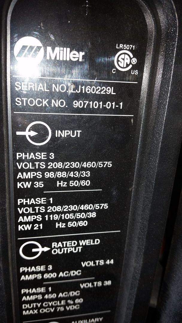

          Thanks for your prompt response, I'm looking for the paper work of what they did to the welder the three times we have send it for repair.
          We are located in Buena Park California.
          Here picture of the tag:
          • #6
            Some of the problems
            This are some of the problems:When starting to weld, the electrode would be energized without the pedal being depressed.The display would then show “HELP – 21”, & welder would not work. During the early Stages of problem, turning the machine off/on a couple of times would return things to normal & would work fine for a short period, then, “HELP-21” would come back to display,& mach. won`t work after that. Have had local repair shops involved. Pedal checks ok. They have replaced a couple of electronic (circuit boards) suggested by Miller factory.I still will look for the paper work listing repairs completed and then post them here.Help 21 DisplayIndicates voltage or current feedback hasbeen detected with contactor off. Contact aFactory Authorized Service Agent if thisdisplay is shown.

              Saulo
              you are only about 50 miles away from Shovelon's shop in Chatsworth...
              Still betting on a default reset ... THEN set it up...

                Dynasty 700
                Thank you for your help, we barely use this welder and a local shop say probably is why is giving you so much trouble! is that true?I will try to reset it to factory settings.Thanks
                  A clean reset to factory defaults will erase any conflicting settings that could be scrambling it's brain... then set it up as per the video for what you are welding...
                  just a hunch... pretty common on these Dynasties..

                    I believe I have had a "Help 21", or it could have been a "help 10, a few times on my Dynasty200. It was caused by the finger controller switched on before I powered up.
                    Could be worth a try switching out the pedal for a while. Sometimes the belt jumps a tooth inside and wreaks havoc.

                      The above poster is quite correct, hlp 21 always means that you've hit the pedal before the machines software has loaded. So either a bad pedal or its connector to the machine was not wiggled in all the way.
                      Changing boards probably did absolutely nothing. You will have to pull a reset and check the pedal's micro switch as well as, undo the plastic plug and check for damaged wires
