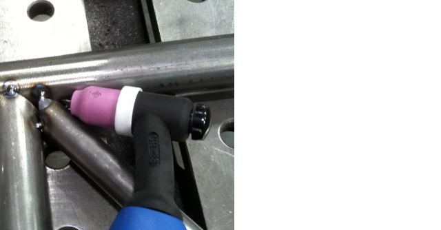

I have a Miller Econotig. I have the wp-17 torch now. Problem is, its toooo big to get into tight areas. Is there a wp-9 torch made that is a direct fit to replace the wp-17? Preferably one that will just replace the torch and not the whole lead. ThanksBrianM&M Chassis Shop

swivel head tig torch
http://www.ckworldwide.com/130-150-a...%E2%84%A2.html take a look at this, don't know if it would work for your machine.
Wp-24

http://www.bakersgas.com/weldcraft-wp-24-tig-torch.html
http://www.brweldingsupplies.com/wel...5-2-tig-torch/Attached FilesLast edited by H80N; 02-06-2015, 08:14 PM..

OR... Extended cup...
In some applications you can get a deeper reach by using the long extended cups...Attached FilesLast edited by H80N; 02-06-2015, 08:20 PM..

Yet Another Option...
Yet Another Option... is getting a 17H "STUBBY" Gas lens kit for your existing 17 series torch.....
http://www.weldingtipsandtricks.com/tig-torch-tip.html.

CK 9 torch
I really like my CK 9 torch with a flex head, bought with superflex cable from Tig Depot. I kept my old torch for when I am using larger currents. The WP17 is rated for 150 amps continuous, the CK9 for 125 amps continuous. The CK 9 is generally set up with the button cap, as I often need to get into tight spaces.
I generally have the 1/16 tungsten in the CK 9, and the 3/32 in the WP-17, although I have 1/8 inch tungsten if I am using larger currents on AC. Stubby gas lens kits are good.Syncrowave 200, Millermatic 211, Victor torch, Propane forge....
