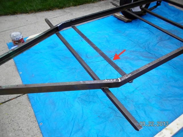

    For reference, below are two images of a trailer frame from the same model of trailer that i have. One image shows a red arrow. This points to an additional cross member that was welded on to that trailer frame as part of a welding repair for that frame. Otherwise, the trailer frame is the same as mine.
    My concerns:
    1.Is the original repair sound?
    2.Did the original repair make a difference and will it strengthen the tongue enough so it won’t snap or crack at the front crossmember? I am concerned with the section where the bending starts upward. This is just forward of the front crossmember. In the “tunnel video” down the C channel to the tongue, I see a slight outward twist where vertical “boxing” to the C channel was done. This is where the tongue is welded(meets) to the frame. I assume this was original.
    3.Will that twisting be a weakness?
    4.Do I need to level out the tongue so it is level with the rest of the frame?
    5.Will that weaken the steel from its condition now?

    1 - Define sound... Its a camper trailer and it was designed to be as cheap as possible and still hold. If you went 200 miles and it was fine, it seems sound to me.
    2 - From what I can see, and it isn't much, the original repair didn't do much except to add more heat and damage the frame more. Once a tongue is bent, the only solution is to make it straight and then sister up the frame.
    3 - As long as the welds are sound, it should be fine.
    4 - If the trailer is fine and handles properly, then leveling out the tongue can do more damage then good. All depends on how bad it is.
    5 - If you sister up the tongue with another piece of channel, it will be fine.
    6 - That added on gusset didn't do much of anything either except to add more heat to the frame already.
    This is all based on information given, but a real answer must be given while looking at the frame up close.
    I personally would grind off all repairs, level the tongue, sister up the entire frame, and it would be good for another 10 years. But I am also a welder myself and it would be cheap for me to do.

      Rod, I feel bad for you because the guy who did the repair work for you called himself a welder, and by the standards of anyone here, he is NOT a welder, but how were you to know!! This might be some of the ugliest work that has been posted here. The guy can't run a bead, and he seems to be vaguely aware of this because he ran pass after pass, adding more and more metal, not that it will do any good. He has no clue as to how to use doublers, how to size them or to taper them out. Rebar has no place in this project, and just the WAY he has used the rebar has me scratching my head. Tell us you didn't pay him actual money, Rob; tell us he isn't passing himself off as a professional!!! in other circumstances, I might think you were pulling our legs, with some sort of elaborate hoax. If this guy is building trailer hitches, somebody should inform the state DOT before innocent people get killed.
      What might save the project is the fact that with mild steel, even some fairly horrible welds can hold up for a long time if not stressed too much. Go to a local shop that sells welding machinery and supplies, and ask them for the name of a local welder that they KNOW is competent. Have that welder come take a long close look at the trailer and advise you. Or maybe you could tow the trailer to a nearby technical college and have the welding instructor take a look.
      As to the photos of the bare frame that is like yours, the added brace (with your red arrow) won't hurt but won't do much either. That is a light-duty and very flexible frame; possibly they were depending on the trailer body to add stiffness. Personally, I'd want an x-member in the middle of that frame, but maybe that's overdoing things.
