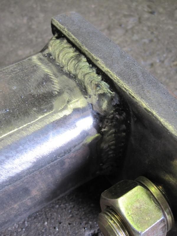

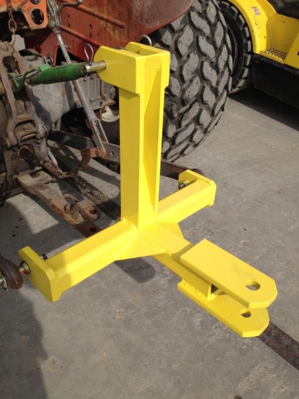

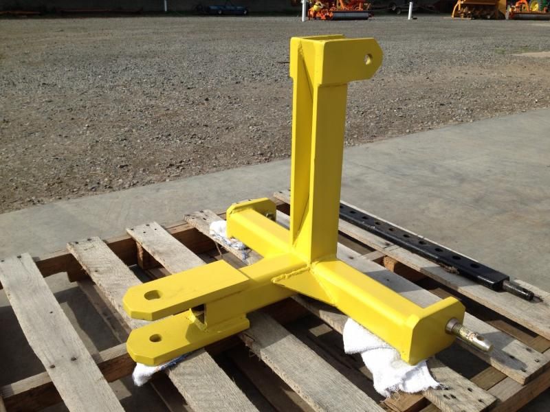

                  Here is what we are currently building at our shop. We have complete 1 & it is being used currently, and are just finishing up 2 more. We will most likely be building 10 more. The customer wanted a hitch that was bulkier & stronger than a locally sourced cheap alternative. He uses them on compact CAT 1 tractors that pull fruit bin trailers for cherry harvest.
                  An operator can more easily load/unload/hook up to trailers running the hitch off 3 point. Also, this places the pivot point of the trailer "further back" from the tractor, allowing for tighter turns without binding & tire rub.
                  The builder is grinding welded surfaces to a "v" prior to welding. He is making 2 passes with 1/8" 6013 on our bobcat 250.

                    The weld in the last pic looks kind of cold.

                        Not to start a war here, but i would teach your welder how to weld with his current setup before you give him another procese to learn. Thoose welds are terrible, they are cold, have poor appearance, and do not speak very highly of the work in your shop.

                            Challenging to do this. I'm inexperienced in the field. Mechanic has been welding on/off for farm machinery repair & fabrication for longer than I have breathed air. Here's the settings he was using on the Bobcat...6013 1/8 electrode
                            60-160A
                            Amerage 4
                            I asked him about the weld being too "cool" and he showed me that it's "biting" in to the material along the bead.

                              Right, no offense intended but those are not going to work out in a commercial environment for long. "Maybe" a farmer making an emergency field fix, maybe not.
                              You are ripe for the picking for any kid with mediocre-decent skills who's been to the local community college welding program and owns a chop saw and a buzz box.
                              That's a pretty harsh end product. The material is cut to size and the paint appears nice.
                              Not trying to steal your joy, but really, reconsider trying to sell those welds. Posting settings or going to a different (more expensive) process isn't going to help.
                              Time welding does not equal a saleable product.
                              Get a new welder, with medium type skills, and go to town. Even if he's a 18 year old, that guys years of experience are not gonna work if you intend to make any money.
                              Just my take, I'd be out of business if I was selling those, even in AgLand.
