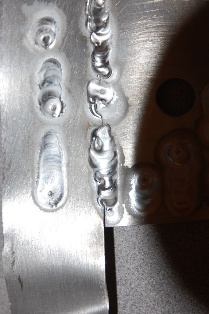

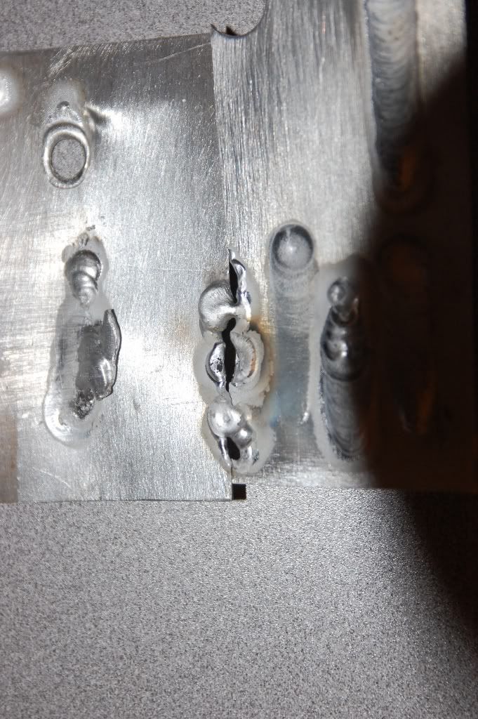

                      late update but I took a lot of advice from here and tried practicing with it. The one that suited me the best was to hit the foot control to max intially, then dab filler, then quickly release the foot.
                      Here's what I got. The first image is 2 pieces joined together, it's kind of rough to see because I hit it with an SS brush.

                        Better watch out or that caterpillar is going to crawl into that hole, never to be seen again.
                        Anybody ever mention to you about backing off on the amps while adding filler at the end of your bead.
