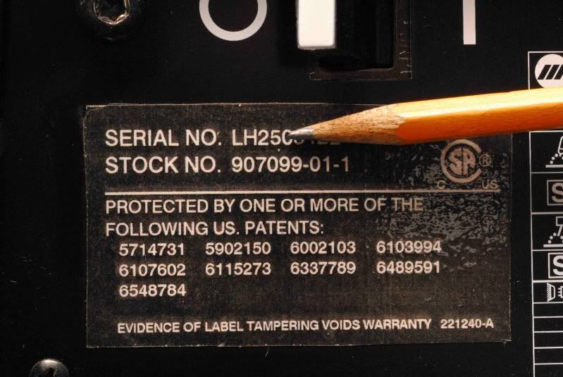

                  I bought a Dynasty 200DX on July 01, 2009.
                  This was a brand new machine on Ebay and it had 'Buy It Now' price of $2850 with free shipping, just like all the rest listed by different people.
                  What attracted me to this one was it also had the 'Make an Offer' choice.
                  I made a couple of offers and was quickly rejected.
                  Then I made a final offer for $2650 with free shipping. The offer was accepted 4 hours before the close of the auction.
                  I felt like I had made a pretty good deal (at the time) and saved a few bucks.
                  Before the machine arrived, I D/L'd a user manual from Miller to look at.
                  When the machine arrived a week later, it had no user manual and it was not in a Miller box, but that did not concern me because I had the D/L'd manual.
                  Then I recently stumbled on to this thread regarding the differences between the 200 DX models. I go out and look at my machine and see it is S/N LH250xxxx. This is the earlier model.
                  OK, there goes the so-called 'savings' I got on the deal, I thought.
                  I put in the serial number at the Miller site and D/L a manual for that S/N and sure enough, I got a different version (earlier).
                  Comparing the two manuals, there were a couple fewer pages in the earlier manual and there was no information about setting the Tungsten Selections or anything about the setting of AC Waveshape Selections.
                  So I get on the phone to Miller's tech department and ask about the differences.
                  Mark tells me that the earlier machine (mine) does not have an ability to select different wave selections on AC and that was about it.
                  So I go out to the shop and take the newer manual with me. I follow the steps given to select tungsten first, and Lo and Behold........ TUN 094 pops up! This is the default setting for a 3/32 tungsten.
                  I adjust this to 062 for my 1/16 tungsten I am using.
                  Puzzled???....... This is not supposed to be available on my machine.
                  Next, I go to the AC Waveshape Selection page and set the machine to AC, turn it off, then back on and hold down the polarity and AC waveshape buttons.
                  Now I get the 4 selections for waveshape showing and I scroll through all four types of waveshapes.
                  I am even more puzzled at this point. My machine seems to be the later model???
                  So back on the phone to Miller and I give Mark the serial number of my machine. He looks it up and comes back and tells me he has no record of such a serial number!
                  He also says.......'I do not know what to tell you.'
                  I ask,....... 'In effect, I have no warranty I guess?' He says that is true.
                  The machine is brand new. The serial number/product sticker on the back is perfectly attached with no sign of tampering, but there is no record of this number. I am just blown away!
                  While I am happy to have the later version with the waveshape settings, I am quite unhappy to have a brand new electronic machine with no warranty!
                  Has anyone run into this situation before? And how could this be so? As I say, everything is brand new. It came with a brand new RFCS-14HD heavy duty foot control, but no cables or torch, which is normal.
                  Anyway, that is how my morning has gone...... pg
                  FYI,
                  Here's an image of one of my Dynasty 200 ser#s.
                  Notice the rounded corners and straight edges. My ser# tag also looks larger since it completely covers the index lines on the nameplate that your's does not in the upper right corner.
                  We'll get it taken care of....
                  Andy
                  • #24
                    Oh Wow! Thanks for the pic. Now I see the rounded corners you are talking about. Mine are just square corners!
                    They sure go to a lot of trouble to make a tag that an expert can identify as a phony with a single glance. I did not know of this difference in the tags before.
                    Thank you Andy.

                    • #25
                      Now that pic looks more like a real serial number sticker.
                      The problem is you're holding a stolen welder that rightfully belongs to someone else, who is probly very sad about it's loss. Is there a real serial number on the machine somewhere?? You really need to find it's true serial number and Miller can check to see if it has been reported stolen and who it might belong to.
                      Before I buy any used welding equipment with serial numbers, I call Miller with the serial number to verify if it has been reported stolen or not. I don't want to pay any money to any theives and perpetuate their sleazy acts!! I can't call every police department in the country, but calling Miller is pretty easy and they're very helpful about checking serial numbers.
                      Hopefully the thief is caught and hopefully the rightful owner is found and hopefully you are reimbursed for your loss of money!

                      • #26
                        Fyi
                        Just so everyone knows.
                        We are working with him to resolve the issue. All the internal ser#s have also been scraped off. The component date codes do show it was manufactured in May or June of this year and the ser# on the unit is from 2007.
                        I am supplying him with the original machine test sheets for him to submit as evidence to get a refund.
                        Cross your fingers.
                        Andy
