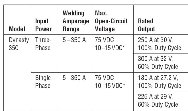

            When looking at the specs for the Dynasty 350,I notice that to get above the 200 amp range you need 3 phase input power.As a hobbyist with no 3 phase in my garage my current dynasty 200DX is about all the amperage I will be able to get with a plug in unit? Mike

              Only the Rated output/100% Duty cycle changes you still get 350 amps on Single Phase

              • #22
                Mike,
                That is not true.
                I know the specs are a little misleading.
                That machine can hit 350A on single phase no problem.
                The machine's duty cycle is just less.
                Andy

                  Okay ,That is good to know.Looking at the product info for rated output it definately gave me the impression maximum peak amperage output was limited with one phase.The directly proportional relationship of phase/duty cycle is good to know.I think the product should be advertised at 350 amp max output on single phase if it can do it.That would help clarify its capabilitys for the home user or those without 3 phase.Thanks Mike

                    It IS advertised 350 amps Single Phase
                    This is from the Product Literature on the Web Site

                        That may be true But if you click on products on theMiller home page then click the dynasty 350 Icon those particular specs state max output at 225 Amps with single phase.Mike
                        • #27
                          I can't find anything that states MAX output.
                          On the right hand side under specs it states RATED output 225amps
                          http://www.millerwelds.com/products/tig/dynasty_350/

                          • #28
                            Broc,
                            With the Dynasty 350, the max ouput is 350A. Doesn't matter whether you're operating the machine on 1 or 3 Phase. Only thing it changes is the duty cycle at a given amps.
                            Same with the Dynasty 200 which has a max output of 200A.
                            Just part of the numbers game Miller and their competition came up with.
                            For us oldtimers, we got accustomed to the Syncrowave 250 actually being a 310A machine. Many referred to it as a 250A Sync but that was not accurate. Seems that all the manufactures have gotten closer to there actual max output when "naming" their machines, particularly with the inverters.

                              Your right it does say rated output but to a novice like myself thats a little unclear.I enjoy hobby welding,,I would like to get a Dynasty 350 or something similar with more output than my 200DX, in the distant future.(I still need to get up to speed with my 200) My point is when I read the specsfor the 350 I was dissapointed because I thought that I would be limted by single phase. Im just saying as far as advertising the product to its full selling potential it could be a little more clear.Mike
