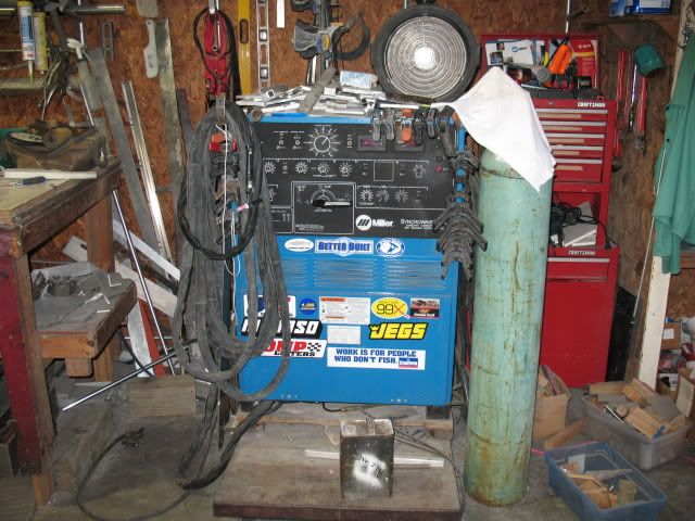

    i was having trouble with the high frequency jumping to start so i changed the contact assembly & that cured that problem but now when you hold the button on when welding continous it does fine for alittle while then starts acting like its losing current & starts sputtering...it only act up on AC hi freq continuous...DC start is fine...whats up with this?

              thanks, i guess it's 2 step...on off on off...welding on anodized aluminum...how would you set to 4 step? not that i would like that just curious...
              • #8
                IF it has it, there would be a toggle switch on the machine. Usually will just say 2step and 4step above and below the switch. (or side by side).
                do you have a close up of the control panel?

                    here's a picture
