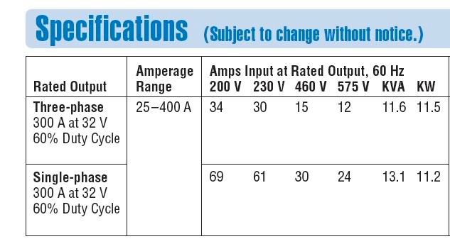

      • #4
        Here you can see the Amp input difference between running the machine on 1-Phase and 3- Phase as well as how the Amp Input requirements change with the Voltage used.
